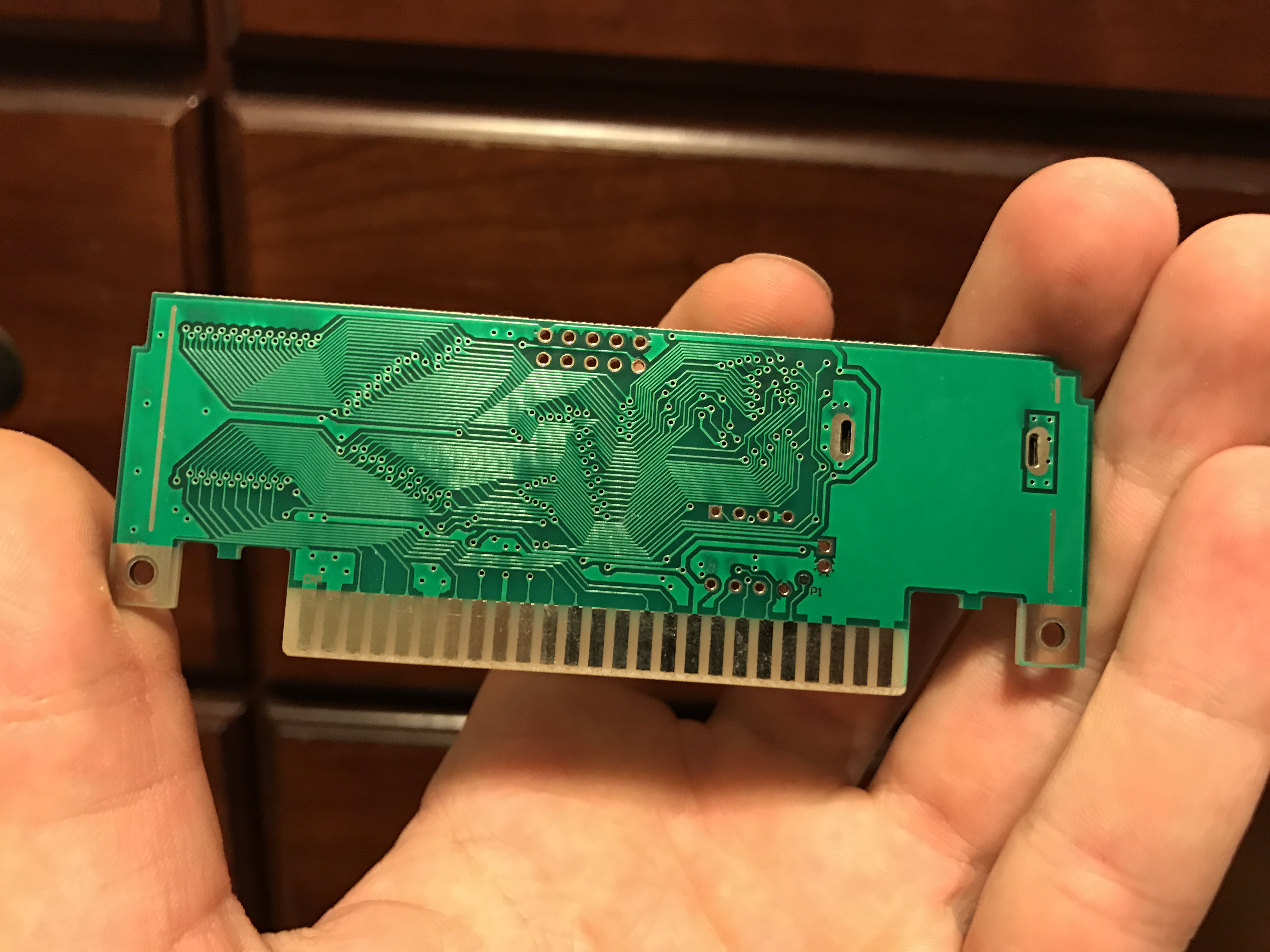

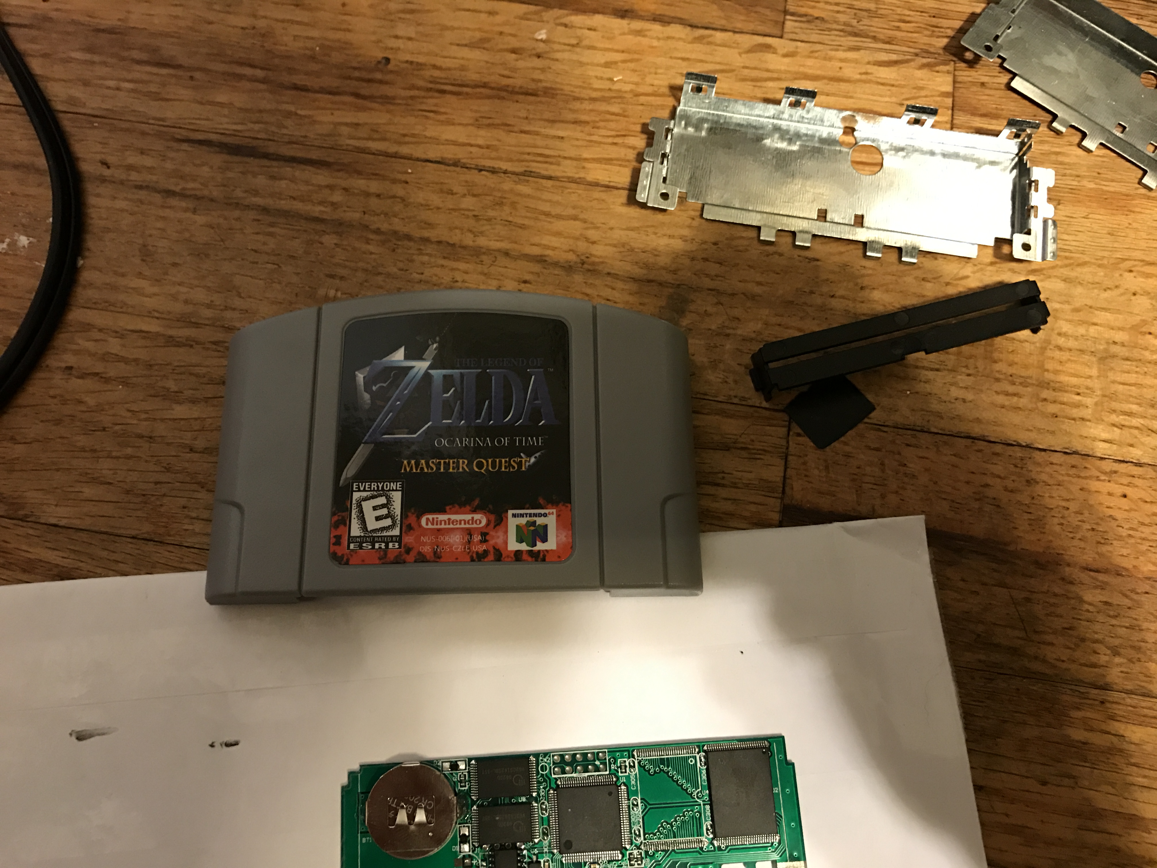

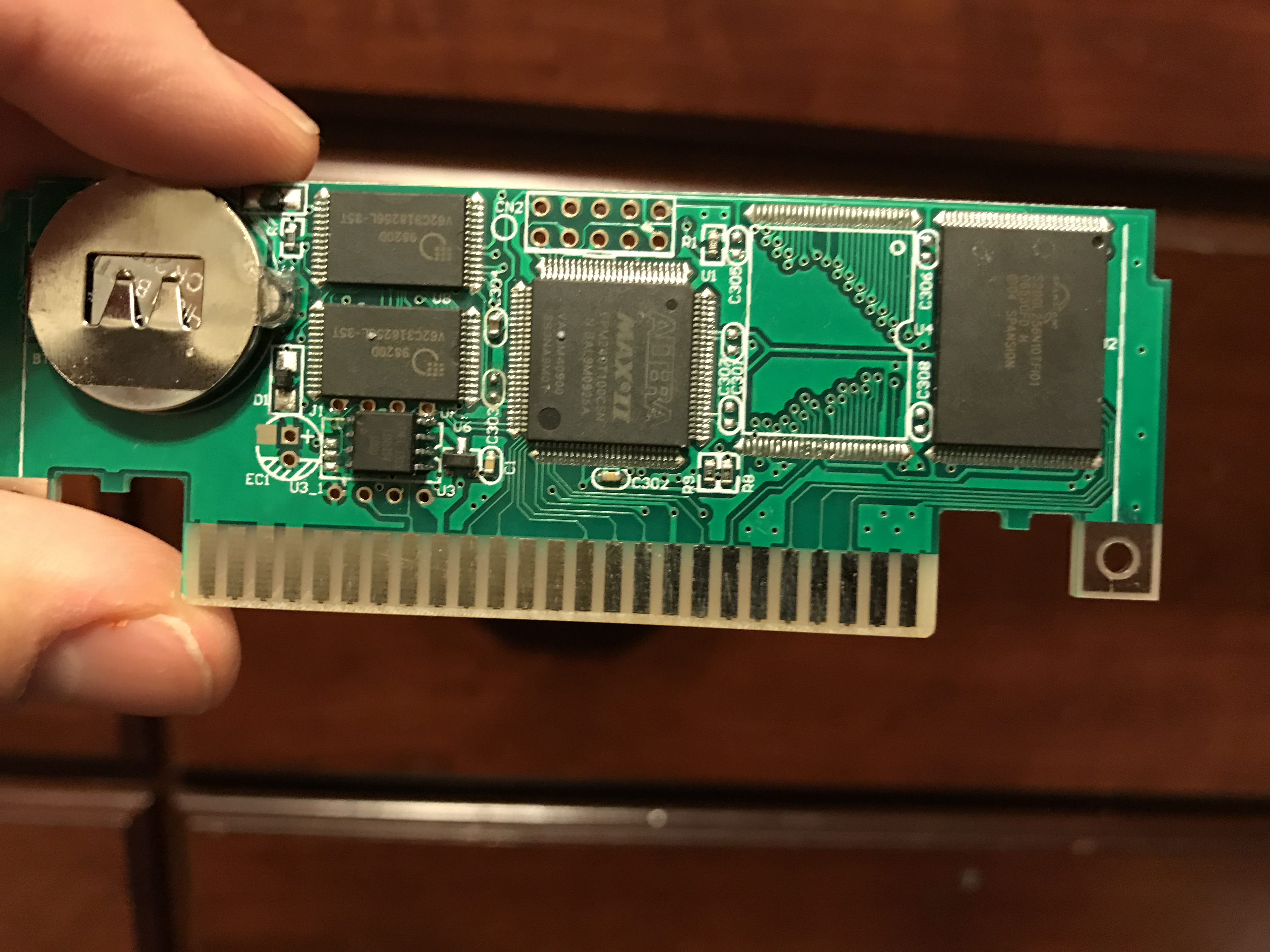

    It has reproduction gamebit screws, reproduction black pcb dust cover, and the reproduction case looks real, however it doesn't feel real (too much acid etching). It also has reproduction shielding, although it appears to be galvanized steal as apposed to plated steal like oem.
    It has a attiny25 ultra cic and an altera max 2 chip.

    Thanks for showing that off, I was expecting a glop top chip somewhere on it. Its made a little better than I expected at $21
  4. takeshi385
    Mar 29, 2011
    1,856
    164
    So was I. My only complaint is the cart is super thick so getting it in an out can be trouble. (Insert joke here lol)

    is that a iscp for the fpga

    Not a pro, but it looks like it. So in theory you could reprogram it just by mounting some header pins.

    Here's a picture of the Conker cart I found in another board, notice that it has twice the flashrom capacity but does not have the sram and battery since Conker saves to eeprom.
    That being said you could buy a Resident Evil 2 repro since it's 64MB and uses sram to save so you get all the chips. ;)

    Imho it will never save because it's missing the 16K eeprom chip that Conker needs and the Max II itself only has 8K of eeprom-like internal storage.
    You could however steal the eeprom chip out of a cheap copy of Star Wars EP1 Racer and solder it into the Conker cart.

    Yes the eeprom is connected directly to the cart slot.
    The pins should be 3.3V, GND,1.6Mhz Clock(cart slot pin 19) and Data(cart slot pin 21) and a bunch of NC. The eeprom uses the same protocol as the N64 controller but with an added clock source. It should be very simple to add to the repro cart.

    Alright, I can confirm that adding the EEPROM does indeed work. I couldn't find a copy of Racer but Excitebike has the correct EEPROM size as well. So, now I've got a nice saving copy of the game. Heads up to anyone else doing this, the ground connection for the battery actually isn't ground. The back of the battery is grounded out against the board. I had soldered my ground connections there initially and it didn't work.
