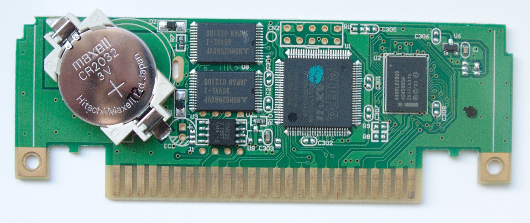

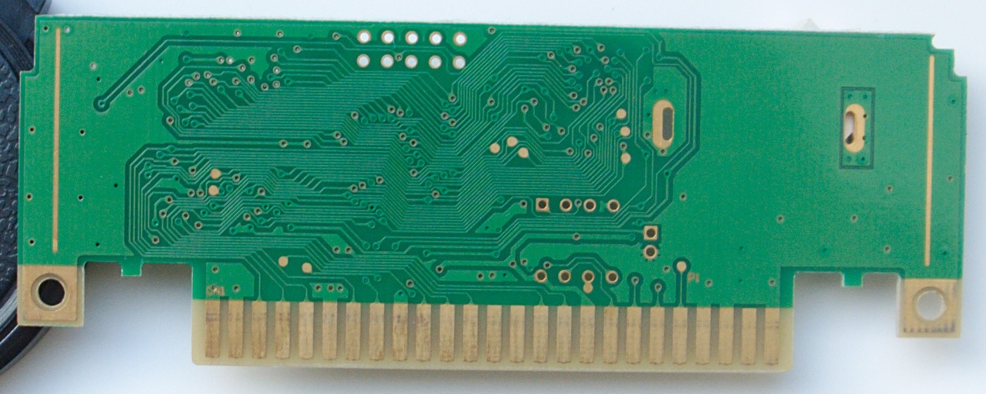

    Fwiw, here's some more shots of what appears to be the same board revision that zouzzz already showed off. Ordered on 15.8., and the ROM on there is OoT:MQ. The build quality is decent, probably could've fooled me had I come across it in a flea market situation (apart from no official MQ carts existing, of course).
