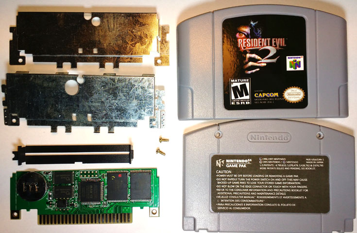

    As suspected Resident Evil 2 comes with a fully populated pcb:
    Build quality is quite nice actually. PCB is 1.3mm thick compared to the 1.2mm of an original.

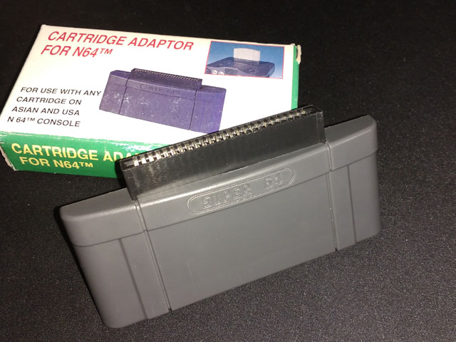

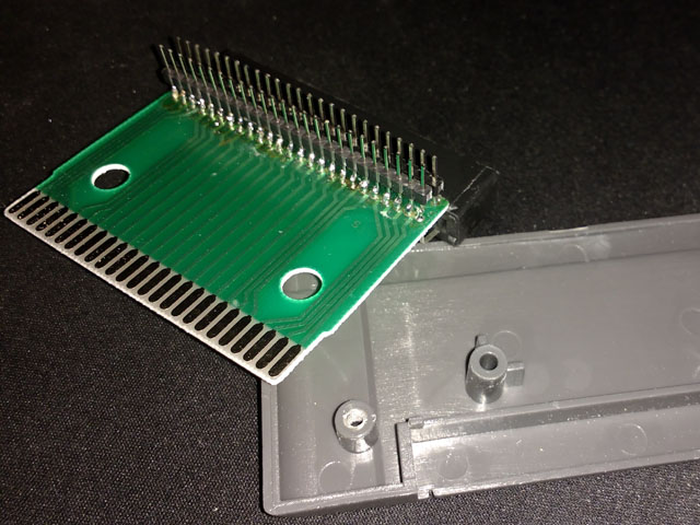

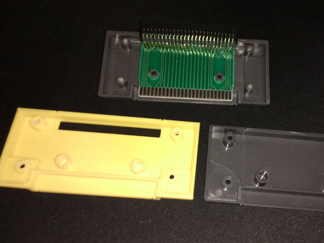

    Bought one of those simple passthrough import adapters.
    The cart slot is angled at ninty degrees exposing all the pins at the back of the pcb. So I soldered two pinheader strips to them.
    Then I spend the rest of the evening making a new back cover so I can plug-in my logic analyzer very easily and listen to all the signals.
