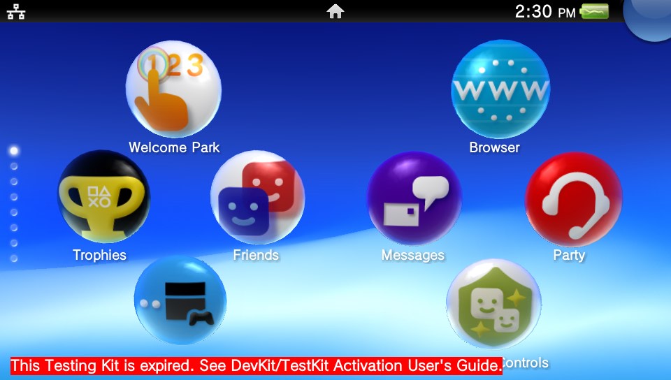

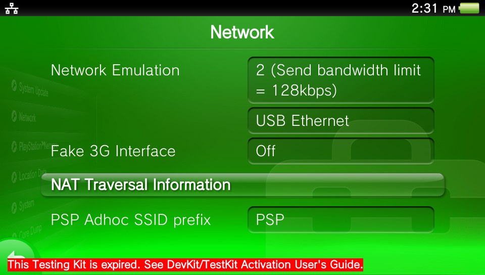

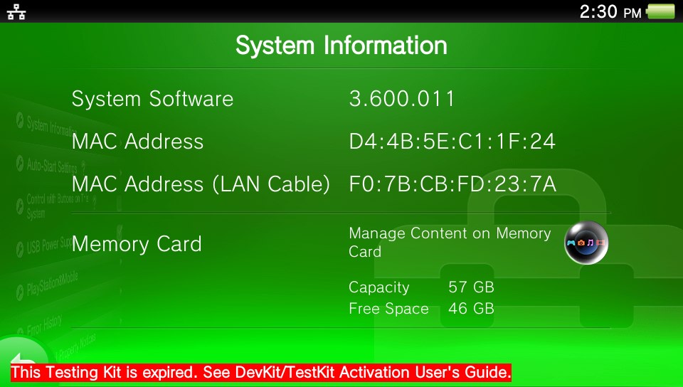

    Today I got the ethernet adapter testing kit limited and working, but LAN connection I I was thinking being able to reactivate my test kit but I have not achieved anything 2017-01-02-143031.jpg 2017-01-02-143050.jpg 2017-01-02-143103.jpg
