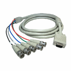

  10. cleeg
    cleeg Rising Member
    Aug 21, 2015
    66
    http://images.esellerpro.com/2242/I/556/99/medscaleVGA-BNC.gif
    Would something like this work? Obviously I'd need to attach this to a BNC to SCART breakout before going to the telly. My ideal solution would be to have this solved without using another wall wart adapter.
    Thanks for your advice on this.
  11. SavagePencil
    SavagePencil Active Member
    Oct 16, 2012
    33
    Oh, I was assuming you'd get a CRT that took BNC, such as a Sony BVM/PVM.
