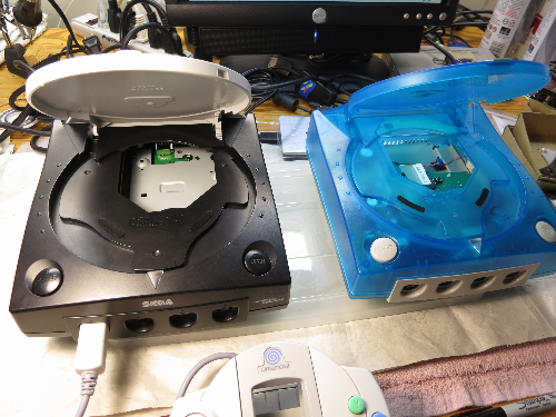

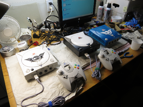

    True story - - I've been busy having a ton of fun installing and checking out the devices side by side !
    (from left to right, Dreamshell/BIOS mod console, USB-GDROM console, and a GDEMU console also with a BIOS mod for region-free play)
    (closeup of USB-GDROM and GDEMU consoles)
    Not much more to talk about until the next revision of GDMenu, or if MNEMO releases new firmware (scrolling names on selection for the long titles that go off the screen would be nice. I have a few small suggestions I will provide to him, but I'm sure they are ones he knows already !).
