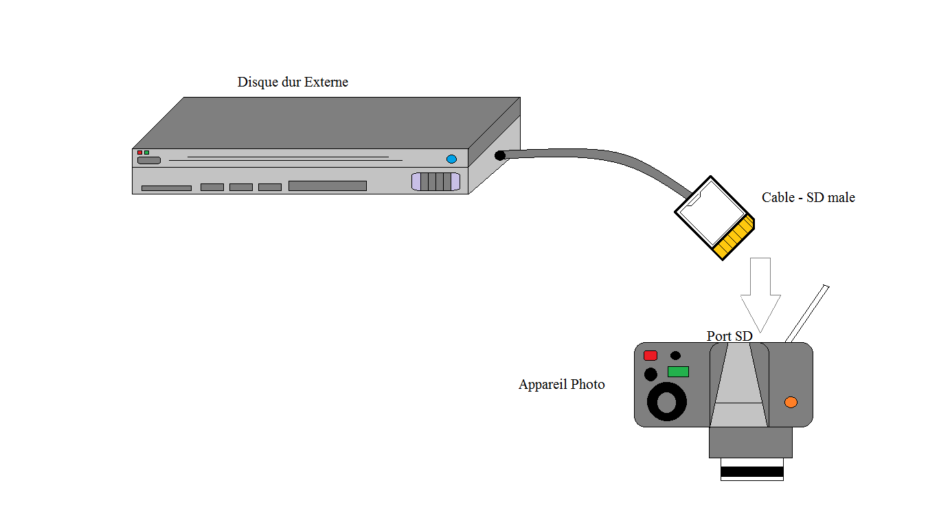

    On a side topic, here's a brainstorm idea.
    Does anyone know of an SD CARD adaptor exists that connects to the GDEMU which allows a USB or SATA or even IDE hard drive to function with it?
    Kinda looks something like this so you get the picture:
    Or maybe this?
    Thanks.
  12. -=FamilyGuy=-
    Mar 3, 2007
    3,032
    891
    Would require extremely fast drives, as the problem with most cards that don't work is that the random seek time gets too long sometimes. I don't know any hard drives, bar SSD, with sd-card level random access times.
    Spec likes this.
  13. Friend of Sonic
    Friend of Sonic Spirited Member
    Jul 29, 2013
    152
    So funny that you mention the Mobiadapter. I read about this a couple of months ago and thought it'd be a brilliant solution for the Rhea, but it's been long since out of production, and no other company has been interested in making a product like it (understandably so). The main issue with the Mobiadapter is that it's limited to the 32GB SDHC specification, so it doesn't really solve the storage issue.
