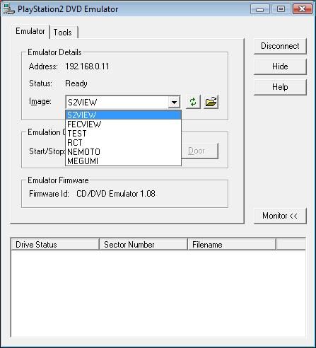

    UJ, did you notice the size of the emulation HDD by any chance?

    the one that works has its emu hdd not empty, I'll try to run the images later and extract them.
    Parris, about the size, it's the same 30GB model as the hdds in my first tool.

    It'll be interesting to see what is actually ON the emulation HDD.
