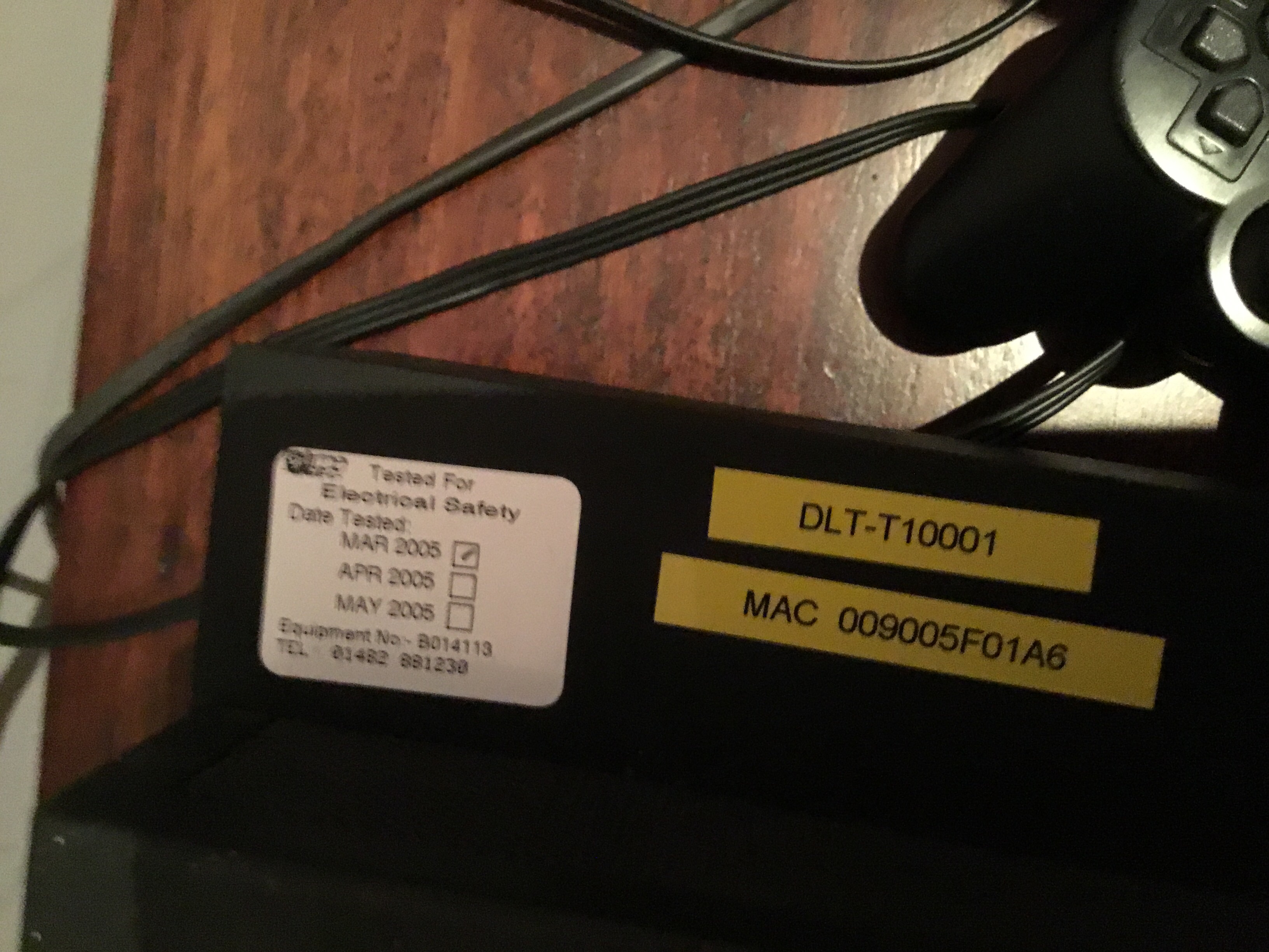

  13. Joshuawthomson
    Joshuawthomson Active Member
    Aug 18, 2017
    37
    Ah yes, I do believe that this unit is European (Judging by the IP addresses noted on the crate) looking closer though, it already had the 2003 ROM when I got it and it was dated as tested in 2005 March
    Also, it would make sense that it is from SONY themselves and not a developer as the system was basically brand new when I got it.
    The last commands were typed in 2005 and they were to test the unit (the dates match the ones on the test sticker) Also the PS2 side had never been posted before. I removed the vertical stand as I do not need it, when I removed the stand I found a stick tag with the name, "Arnaud" written on it. From what I know is the Arnaud was an engineer back in the day. Amazing what you can find with these units.
  14. sp193
    sp193 Site Soldier
    Mar 28, 2012
    2,217
    1,052
    The TOOL's flash ROM is supposed to match the SDK that the game was developed with. Even if it is possible for the TOOL to be reboot with the IOPRP images that games ship with, the DECI2 modules and kernels will still be old.
    There are a few implications here. Other than simply losing newer features like the EE thread extension, I am pretty sure it is difficult to run a modern game on the original ROM v1.00 because the game would incorrectly patch the TOOL's EE kernel (it identifies as an early kernel, but the region of free space reserved for the patch is not the same as a CEX/DEX's).
    Are you sure about this? If you've actually seen this happen, that would be really news to me. But I have doubts that the developers link the TOOL and the DEX that way because there would have to be also PlayStation 2-based software on the TOOL to handle debugging like that.
    If you do find it, can you show us the part where it mentions that?

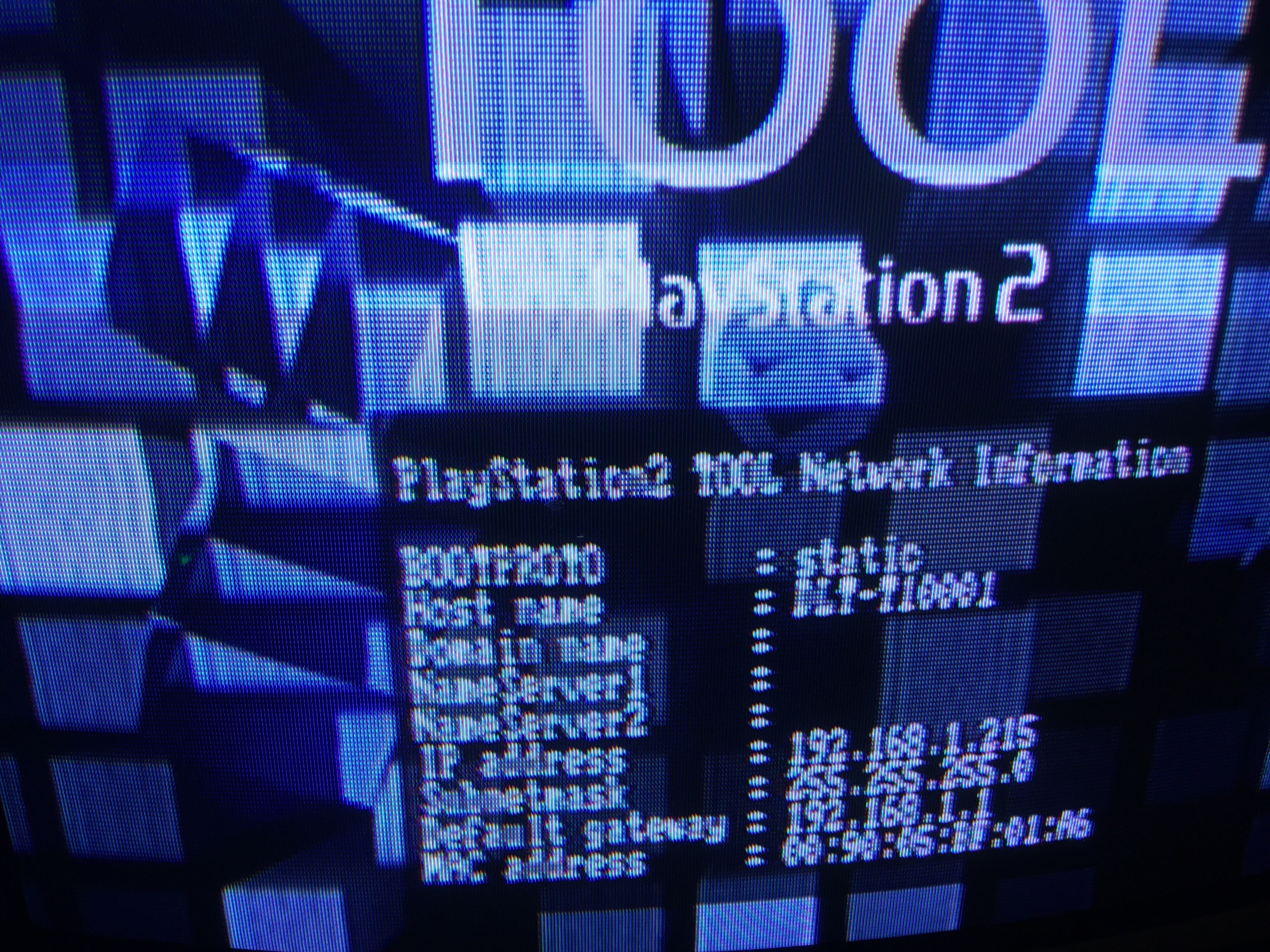

    Can you confirm whether its sticker really reads "DTL-T10001"? Your TOOL's information screen has a mispelled name there ("DLT-T10001"), and I didn't see you show its model information sticker number in the video.
    If it's really a DTL-T10001, then it would have been a US unit. Usually, a "01" there indicates that the set is a US set.

  15. Joshuawthomson
    Aug 18, 2017
    37
    Hmm, I’m not completely certain about i.Link being used as debug. I do remember something about debug via the IOP like that... once again not certain, it’s a faint memory. Do you know the serial mod (used in retail fat consoles) I do remember some similarities to how it works. It wasn’t intended to deploy the games (I can imagin trying to load a game through an i.Link cable XD) It may have been done on the PC side using Putty...if it was like the serial mod. Once again, not sure.
    that may have been my bad about the IP
    Although I did obtain my unit in Europe so that might explain the ip.
    If I find where I remember seeing the I.link and WS information I’d be happy to post it.
    Here is my sticker and info screen
  16. Logi26
    Logi26 Site Supporter 2014
    Jun 17, 2013
    295
    94
    I think he is talking about the the official model number on the rear of the system:
    The image that you have provided is just a sticker added by the studio.
    That may have just been used internally to identify the unit.
  17. Joshuawthomson
    Aug 18, 2017
    37
    Okay, mine says the same as yours, so mine is a t10k. Thanks for clearing that up xD
    I remember turning it on and seeing 10001 and I was so confused.
