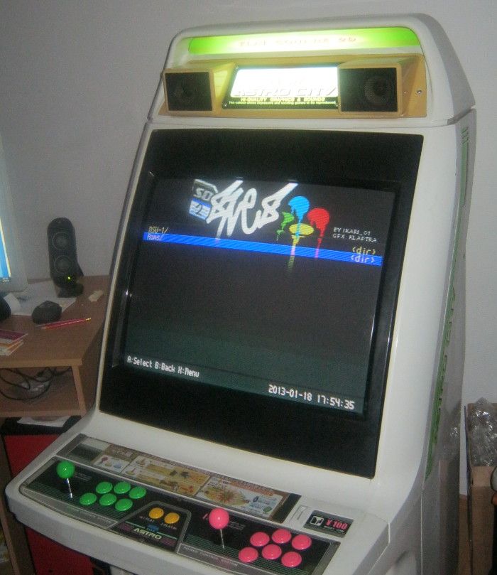

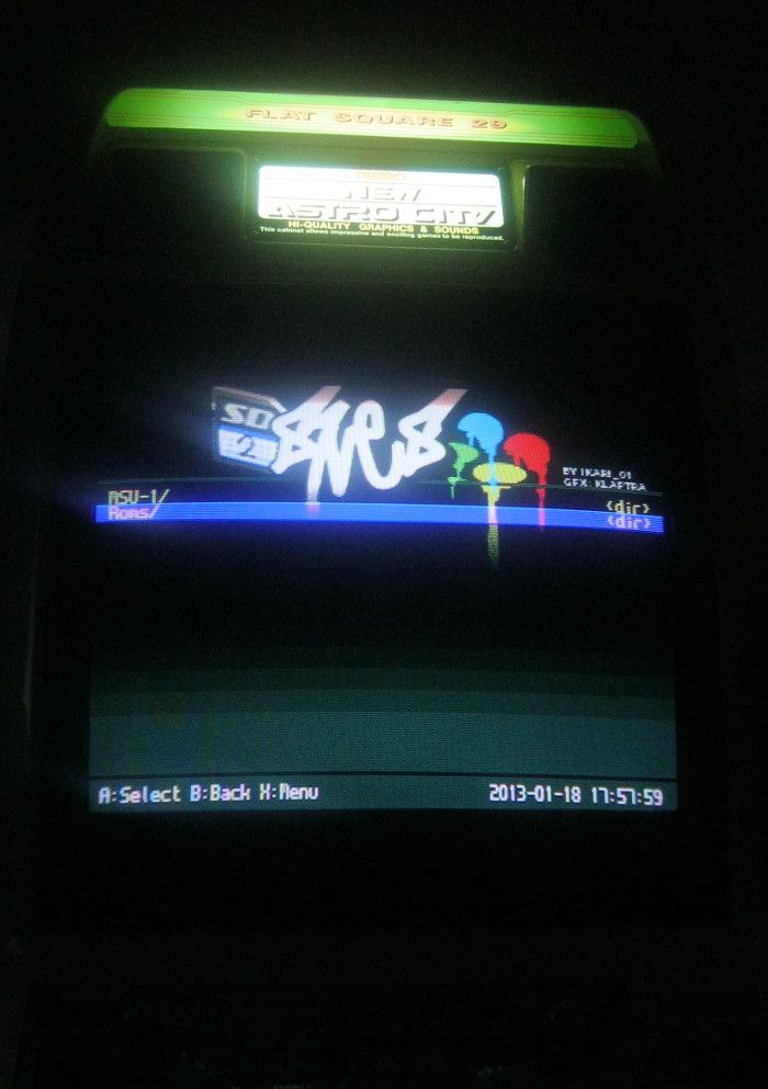

    This thing then... 1 chip snes with sd2snes and supercic and igr mods with viletim scart to jamma v2...
    I have video and sounds working now.
    Lemony Vengeance Snes padhack will be here soon so I can start actually using this without a gamepad...
