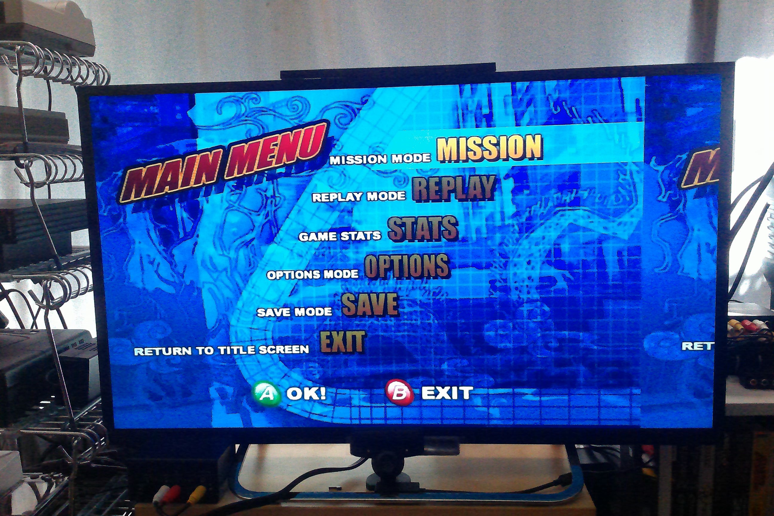

    After about eight months and spending outrageous money on postage, I finally got Enigmah installed on my Xbox. Only to discover that, contrary to what I was informed, PAL games cannot be forced into 720p or 1080i. I am really at my wits end with this console and at this stage feel very tempted to pick it up and smash it.
    Now, even when I boot up a PAL game it loads at 480p. I've tried switching Engimah over to PAL and going into the softmod settings to disabling 480p, but it still loads the games in 480p. This is a downgrade, as they were running at 576i before the softmod.
    How do I restore 576i?

    It doesn't look like an improvement my end. It looks compressed and literally rough around edges. And furthermore, I make recordings with an Elgato HD. Before the softmod, my Elgato software would deinterlace the 576i to 576p. So now at 480p my recordings are actually lower res. The only reason I got this damn softmod was to force my games into 720p or 1080i without any need for an upscaler. Now all I can get is 480p. It is a downgrade, I hate how it looks, and I can't turn it off.

    The Xbox will only generate 576i if the console video mode is set to PAL. From the sounds of it, you switched over your console to try and enable HD, so now it's in NTSC mode.
    The easiest way to switch it back is to use a little single-purpose application called the "Enigmah Video Mode Switch Disc", which does exactly what the name says - it lets you toggle the console between PAL and NTSC mode. If you find the change doesn't stick, then check to see if your softmod has a virtual EEPROM, and if so disable it.

    I've tried switching it back to PAL in Enigmah and its not working properly. Sometimes it boots in 576i. sometimes it boots in 480p. But now an even worse problem has developed. Some games are crashing the console when I try to load them, and in some cases the image is shifted horizontally, with the right part of the screen emerging on the right of the screen.

    OK, this sounds like the problem I mentioned earlier with the EEPROM virtualization - basically, you are changing the softmod's shadow copy of the EEPROM and not the hardware EEPROM. Since a softmod boots through the original MS code, this can result in things getting confused.
    Unfortunately, I can't tell you the exact steps to take to get around this, since it depends on which softmod and/or installer you used to set it up. You could try creating a file called "eeprom_off.bin" (it can be blank) in the E:\ partition and then running Enigmah again and see if it sticks this time.

    Well, I got the softmod removed and got my 576i back, but its still problematic. Deus Ex keeps rebooting the console back to the MS dashboard and sometimes there are weird horizontal lines across the screen, almost like something corrupted. I'm at my wits end. I'm feel ready to pick up the console, throw it out the window and buy a new one. Any suggestions?
