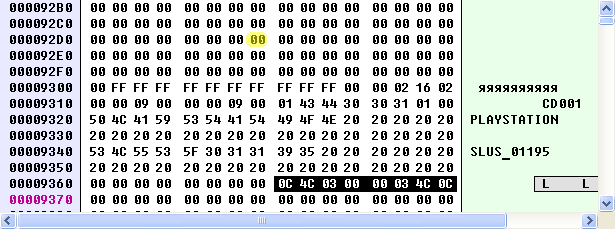

    Sorry if the Hex Edits I made are going a little to far, I love using the HDDOSD and hoping that other can use the Hex Edits dumps for any good. I know that richi902 made a blog on how to setup a Game Partition named "Install APPS/Elfs to the PS2 Browser/Game Channel(updated)" but a lot of info is no in it. Mostly the hex sizes for how to add the icons and icon.sys and others, so its almost no help is not average user friendly, :(
    I see that ELPatas tested it but I'll try this as well. As soon a I get home.

    After having tested the LSN.BIN, i tested the game Wipeout XL US version with the valid header you
    provided and is nice to hear the CDDA tracks, but unfortunately the game don't runs perfectly fine.
    When i whatched your video before don't noticed that the game don't have the voices and sfx
    sounds for weapons, starting race, extended time, autopilot and all the items, you need use a lot
    them for notice better the problem.
    When the emu try to decode them you can hear a very little crapy noise and then mutes, not as
    obvious as the first Wipeout, if you play a lot, one of this faulty sounds stutters in a big noise and also can freezes the game, (i got two or three freezes after playing a lot because of the sound).
    The game have a few slowdowns in certain points of the circuits which are hard to notice in the
    slow Vector class and Feisar ship, is needed playing in the fast Rapier class with Qirex ship por
    example.
    I tested the game in the real psx and the cursor is also a bit slow in the "Load & Save" menu,
    then seems is ok in the emu.
    I don't know if this problems happens only in the poc2, if happens also in your last revision
    i hope can be fixed.

    Yes. The location of tracks and their gap are incorrectly dumped by the ELF I've posted, so the music of CDDA tracks may not start/end where it ought to. If you dump the TOC of the same game two times, you'll see that the 2 dumps don't match.
    Yes I'm interested by your TOC dumps. Contents aren't copyrighted so no worries.
    Some games may crash whilst trying to read CDDA tracks when they're not indexed (ie : when using the Bishi Bashi TOC). The crappy TOC dumper fixes that problem because the total number of sectors and the number of tracks that are written in the dumped TOC are right. Although, it dumps wrong MSF locations.
    I'm currently writing a DOS tool that will convert BIN/CUE dumps to a valid disc image for use with the emu.
    For now it parses the cue sheet and outputs a POPS header. The vomited POPS header lacks 2 entries : The lead out location and the dump size in number of sectors. Work in progress (slowly, but as much as I can)...
    Thanks again for your tests and for your patience.

    Yep, a good old MS-DOS command prompt app. But the release will come with the source code attached, so could be ported or rewritten later
    Haha, I took my French copy of Ace Combat 2 and open the SYSTEM.CNF...
    Lacks a slash. Should be cdrom:\SCES_009.01;1, hence why DumPops cannot parse SYSTEM.CNF
    Shadowman had a similar issue with previous builds of DumPops, because there was no ;1
    Thank you for uploading your TOC files !
    It's amazing that the emulator can reach all tracks with such shitty TOCs. I don't understand why each time DumPops invokes cdGetToc/sceCdGetToc, it returns a load of garbage in the buffer. Segment_Fault made a working TOC dumper during the POC1 era, but since we're no longer in good terms... anyway, we'll not need that thing anymore as soon as we can use a PC tool.
    LSN... Well IOPCD doesn't support that kind of stuff, so I don't get why it works. Some games use FILE access to read from audio TRACKS:wink-new:, in this case I can believe that a valid sector count is enough, but it does not explain why the emu actually run games that have an unsuitable TOC like the LSN.BIN. Nonsense:stupid:.
    CDRWin vs. IsoBuster. Project maintainers had difficulties with their TOC generator. TOCs resulting from CDRwin cuesheets were invalid because of pregaps. It caused CDDA tracks to not play from the correct location. So I've added an optional command in my tool that allows the user to add/substract 2 seconds (pregap size) to all tracks MSF, just in case it happens.
    Todo : disc image I/O, lead-out MSF, sector count, NTSC patch.
    Not sure I'm going to put a NTSC patch thing, because I already expect that the resulting aspect will be crappy (and the patching process slow as hell).

    As i know sector count is the most easiest stuff to realize. Just copy value from offset 9368h (or mirrored at 936Ch)
    Yea I know that this value can be wrong cause to wrong image, but... But the game reads sector count from here and if the game can start with wrong value it means that this wrong value can be stored in the TOC. Finally its not your work - checking if image is correct. End user can you some third party programs for checking images (such as GetMD5)

    Yeah. However it would be better to do a complete re-write rather than a simple port. Since I'm an amateur, my source code is full of dirty tricks and math.
    Yep, that's actually what DumPops does when it says "Reading the 16th sector":encouragement:.
    For the PC tool I think I'll use another strategy :
    1) Get the dump size
    2) Get the sector size (if the dump starts with 00 FF FF FF, sector size is 2352; else assume it's 2048)
    3) Divide the dump size by the sector size
    4) Copy the sector count I got in the above step to the header
    5) Convert it to MSF
    6) Copy the converted sector count to the lead-out MSF field of the header.
    One thing I can tell is that my tool will not support multi-binary cuesheets (cue sheets that use multiple file for each track). It'll only work with stand alone raw dumps (one bin + one cue). Users can convert their "splitted" dumps with some other software I guess, like IsoBuster, CDmage or such ISO manipulation software.
