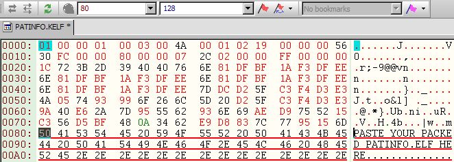

    krHACKen Enthusiastic Member
    Oct 24, 2012
    571
    376
    PLANB_PATINFO.KELF
    Plan-B for modifying the POPS PATINFO.KELF without unpacking/packing. Hexeditor haters will get served:livid: :
    PLANB_PATINFO.KELF
    Offset 3F50h = "CRAB!" (5 characters)
    Offset 3F57h = "BATTLE!" (7 characters)
    Result : hdd0:/POPS-CRAB!/BATTLE!.ELF
    See what I mean ? Replace "CRAB!" and "BATTLE!" with what you want. Keep the same amount of characters (keep in mind that we are messing up with packed data here), don't overwrite anything else.
    Examples :
    Offset 3F50h = "H4X0R" (5 characters)
    Offset 3F57h = "IS_LAME" (7 characters)
    Result : hdd0:/POPS-H4X0R/IS_LAME.ELF
    Offset 3F50h = "12345" (5 characters)
    Offset 3F57h = "EXECUTE" (7 characters)
    Result : hdd0:/POPS-12345/EXECUTE.ELF
    ... or just code your own ELF launcher.

  8. krHACKen
    Oct 24, 2012
    571
    376
    If you embed the POPS ELF using the FMCB installer, don't forget to replace your CARD signature with the original DVDELF DISK sig after ripping the injected KELF out of your Memory Card :
    The BIOS region must match the game license area : If you use a JAP BIOS (or the original PS2 POPS BIOS), the game has to be licensed for Japan. But, like mentioned by l_oliveira :
    3 ways to sort the region issue :
    - Replace the BIOS with one which matches the game region
    - Change the game lice area so it matches the BIOS region
    - Replace the POPS BIOS with an old SCPH-1001 BIOS
    The POPS header of MYDUMP.BIN is identical to the one of the original disc0. You may insert that header in your game dumps.

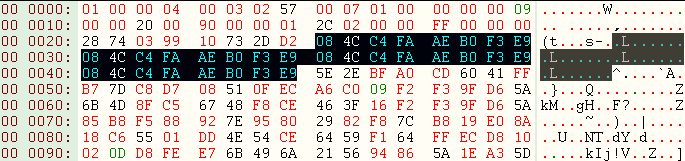

  17. AKuHAK
    AKuHAK Spirited Member
    Jul 25, 2012
    172
    46
    Guys feel free to edit this list with game compatibility to POPS. Its opened for community - everyone who has a link can edit this.
    View attachment fgdg.txt
    Yes PATINFO.KELF after repacking stops working - so I have to use this annoying trick with editing already packed KELF (maybe krHACKen uses some strange and unknown packer-unpacker). I have to remove first 80 bytes for unpacking KELF and after packing have to return them back and after that KELF stops working.
    As about adding JAPANESE info into disk PS1 - we have to change first 11 sectors for any from Japanese disk (this sectors are identical on all disk and exist in 3 forms: PAL, NTSC-U and NTSC-J). Maybe it will be better to change next 4 sectors (that are responsible for EDC/ECC) but in all disks that i was tested it does not affect ))
    Next check disk in ECC regen and add pops loader. If someone need i was making simple disk builder.
    One more trick - if you are using disk with audio tracks - you can extract first track for reducing disk image size (cause emulator doesn't support audio cd). Just open i CDmage and extract first track in any format.

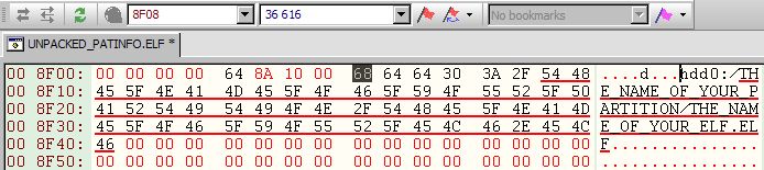

  19. krHACKen
    Oct 24, 2012
    571
    376
    The original packed ELF has 2 protections I had to remove (CARD sig verification and n2e checksum), but otherwise it's n2e packed and to be n2e packed. ps2-packer 0.4.1 did work for me. So the problem might be due to ps2-unpacker being unable to unpack my packed ELF properly (if so, I don't know why).
    Check out that stuff : RR4_PATINFO.RAR
    - Open UNPACKED_PATINFO.ELF in your hexeditor
    - Jump to offset 8F08h, write the ELF path you want and save it
    - Compress your altered ELF with ps2-packer 0.4.1
    - Put your compressed ELF back in the KELF container.
    And in case of ps2-unpacker failure, always hexedit my UNPACKED_PATINFO.ELF (rather than packing then unpacking then packing then unpacking...).
