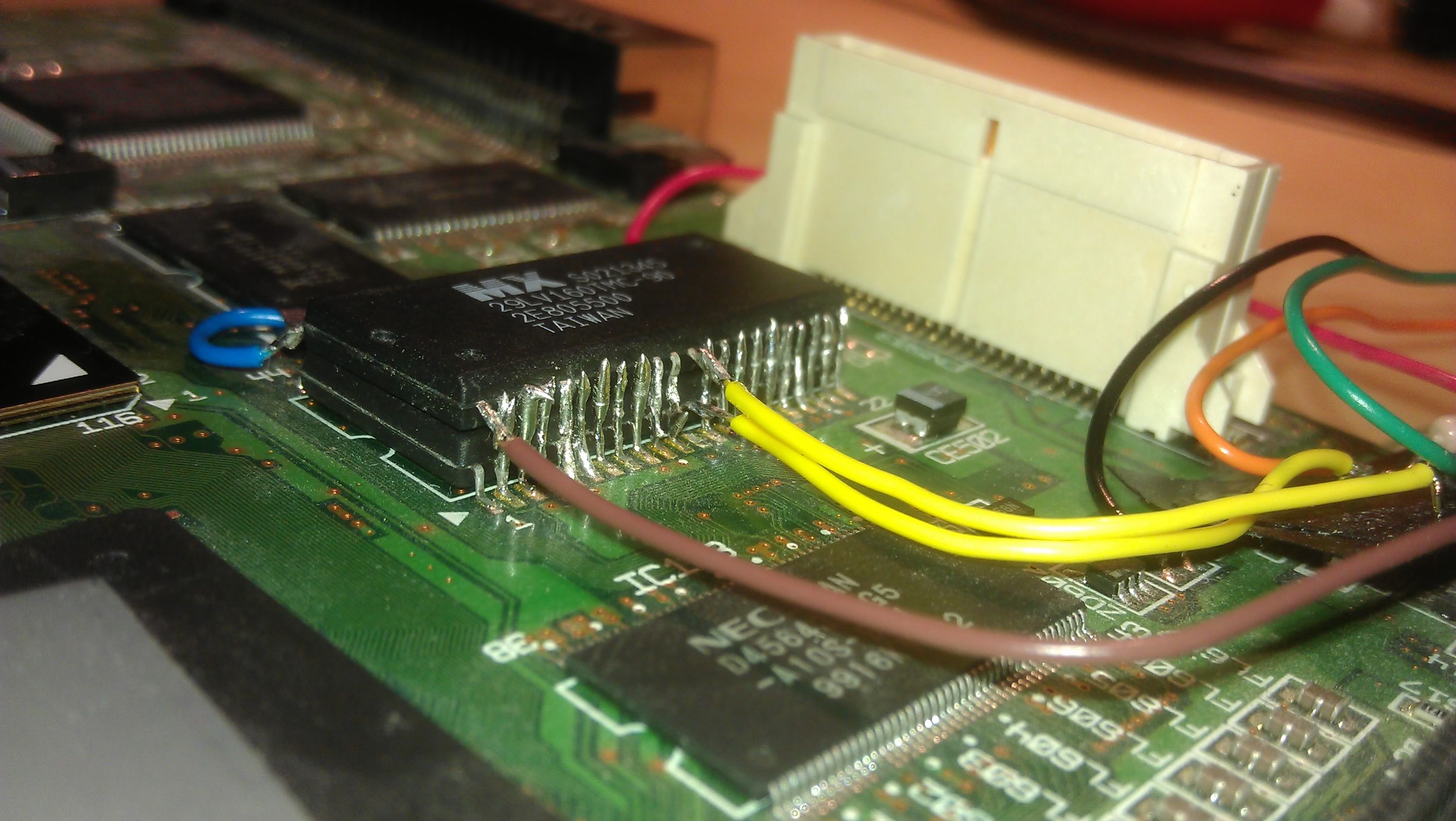

  16. -=FamilyGuy=-
    Mar 3, 2007
    3,034
    893
    You could try to open it to see if there's a internal switch, or a possibility to add one yourself. Else your only bet is to unsolder the bios and either flash it and put it back or put a new flashed one there.
    Anthony817 likes this.
  17. krisk77
    krisk77 Peppy Member
    Jul 20, 2012
    351
    49
    I checked and there is no internal switch, just 3 wires soldered from the bios chip to the MB. My soldering experience is at a beginner level and I don't currently have the skills to perform advanced mods, so i'm kinda stuck.
  18. -=FamilyGuy=-
    Mar 3, 2007
    3,034
    893
    Is there a single chip or rather two chips one over the other?
    Like on this picture (click to expand):
  19. krisk77
    Jul 20, 2012
    351
    49
    It's not piggy backed, just a single chip.
