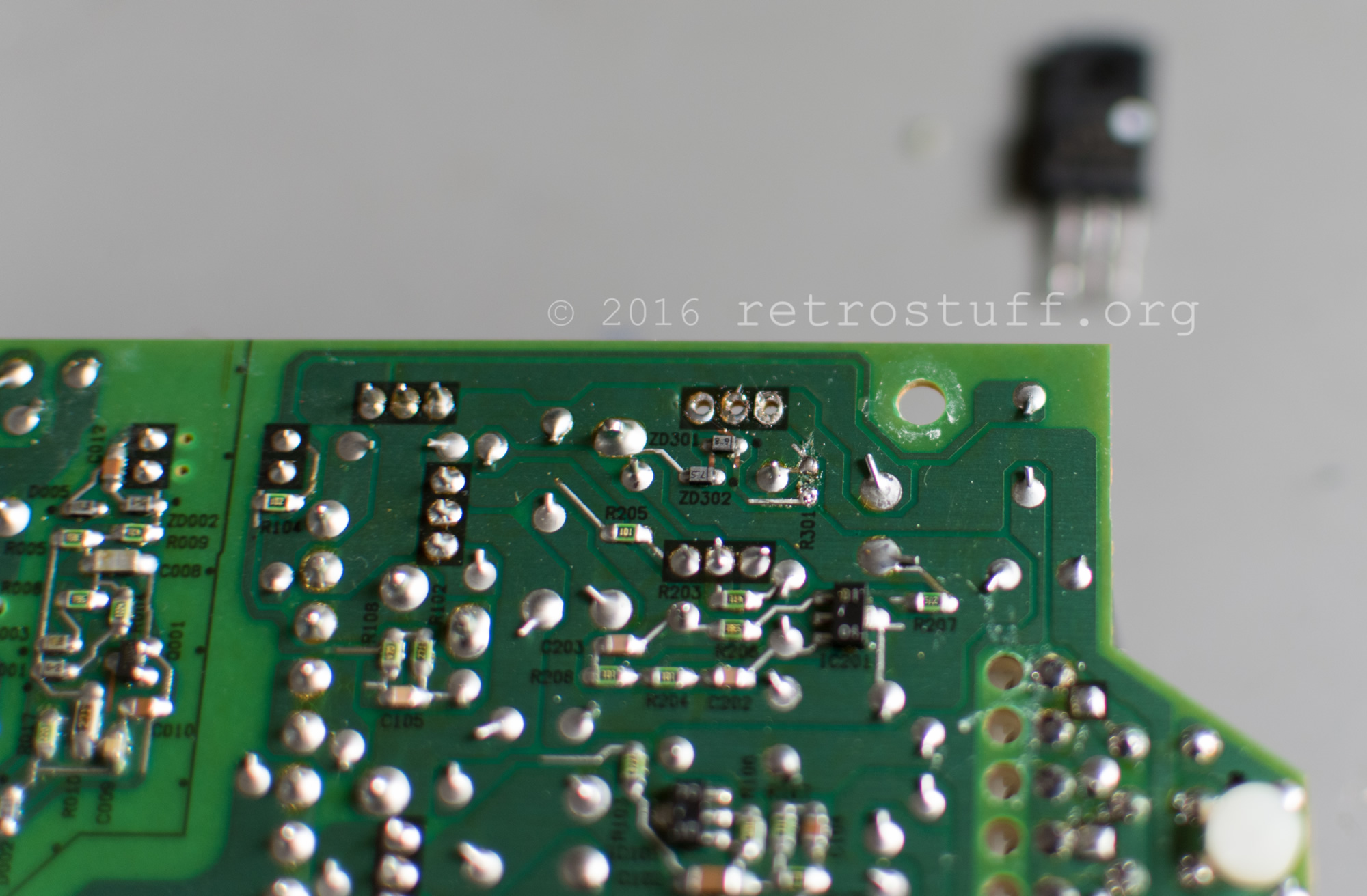

    Also when i was opening up my DC today, getting the drive out in prep for when it arrives, i noticed a small swicth on the bottom of the case. After further investigation ie opening and stripping the DC down to the motherboard i find what i believe is a modchip of some sort. However as i bought this DC 2nd hand years ago i have no knowledge of what the chip does. Heres a couple of pics, can anyone shed a bit of light on this?

    That looks like a region-free modchip. It was used to play imported games before we had region-free bioses.
    We can't really tell you what the switch does unless you show us where it's soldered to.

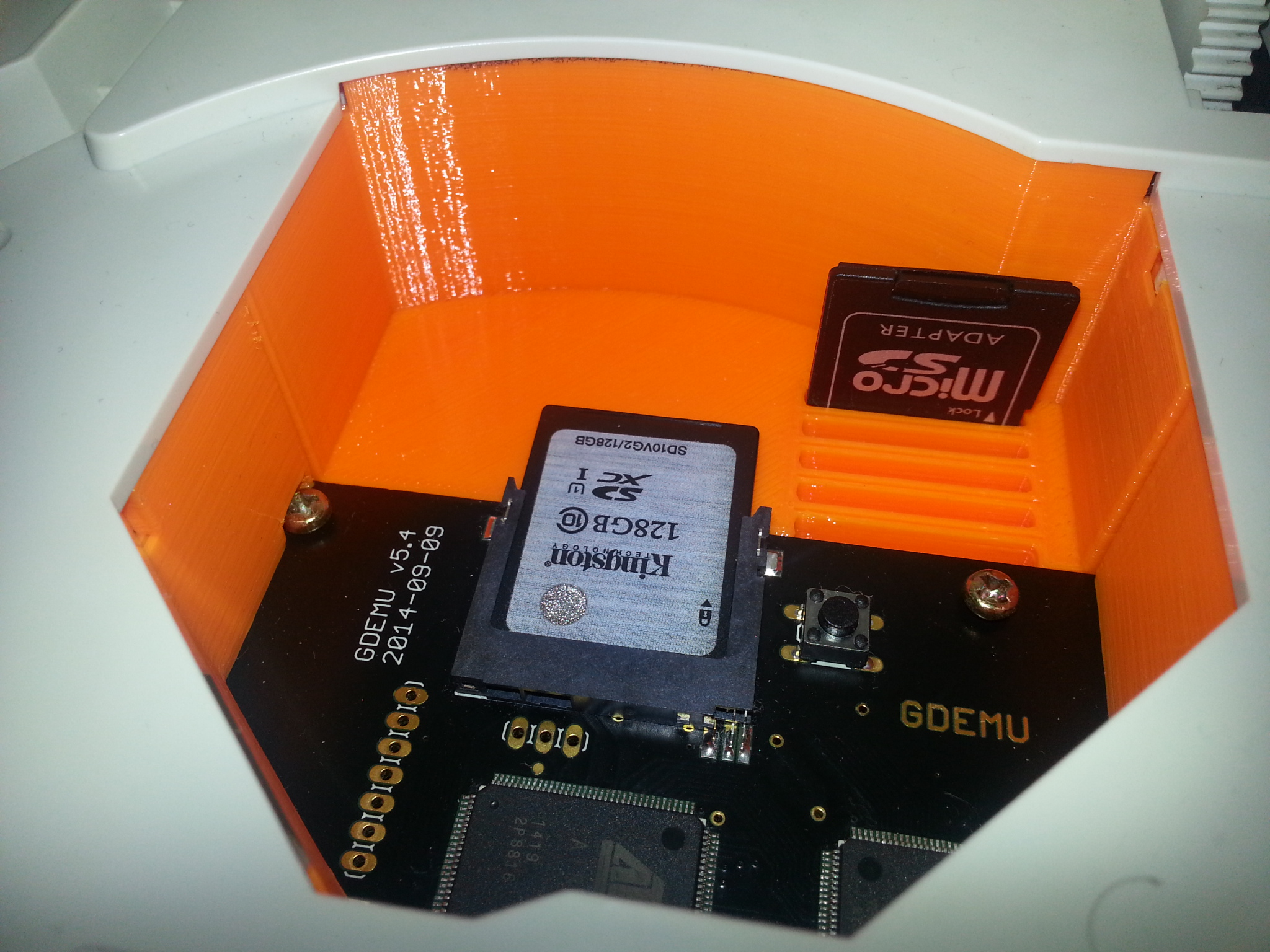

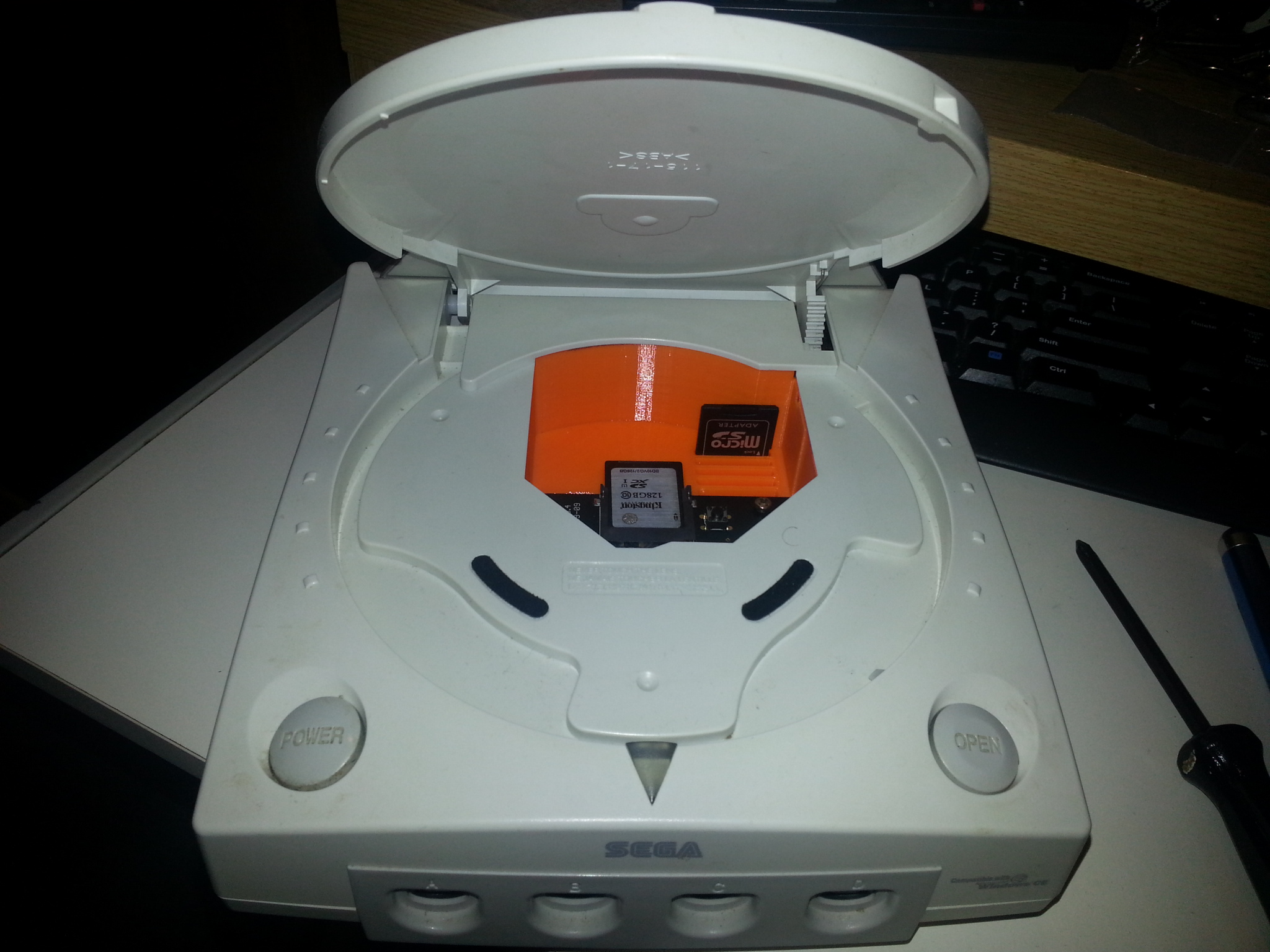

    Do not fear of getting the 128GB SD from Kingston of that type 'cos I have been using it for a few months now with no issues. Use format32 to format as well. I used to have a 32GB only to realize it just didn't cut it. Now with the 128GB, I feel like it's a decent size. I got 107 games (mostly gdi's) compared to less than 30 games on the 32GB. Anyway, here's a pic of my unit along with the newly printed GDEmu tray. Perfect orange match for my North American console.
