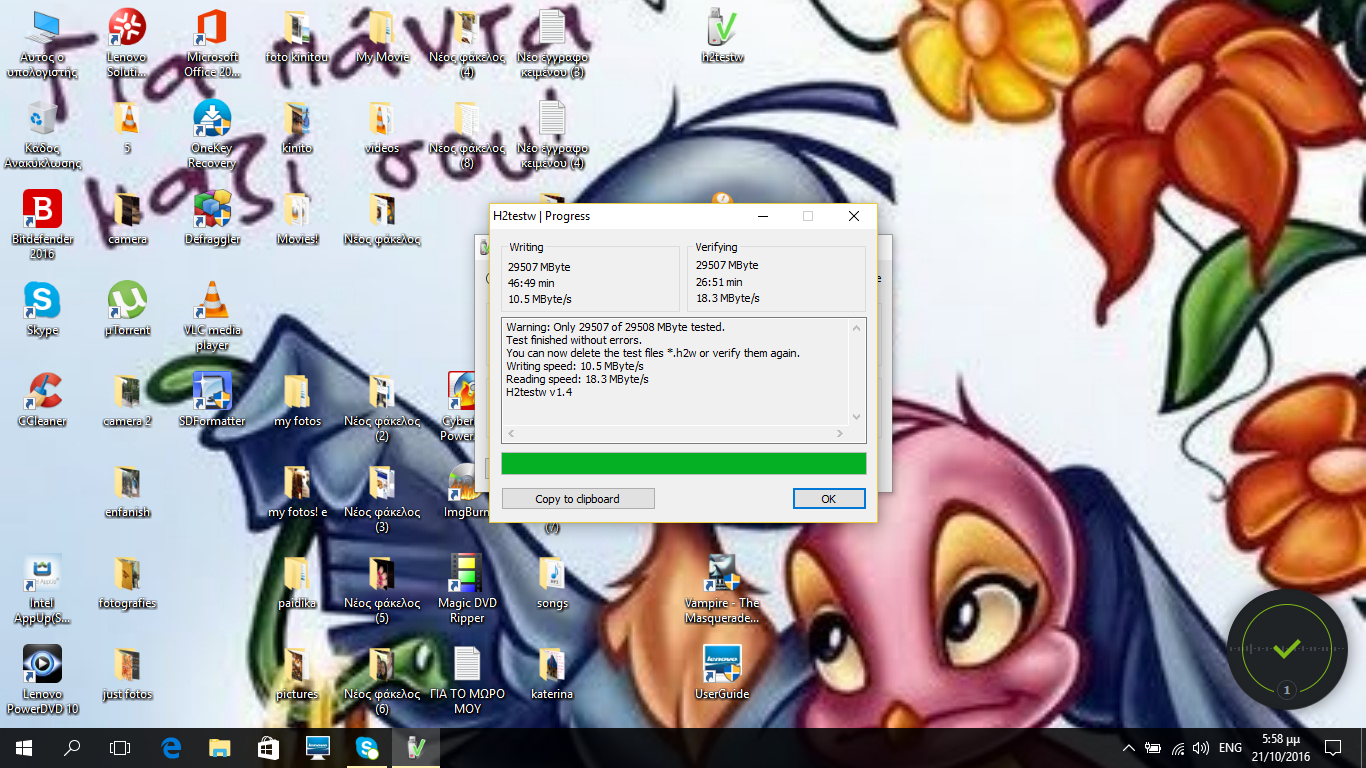

    looks like im in trouble the gdemu crash after 1 hour of gameplay regadles the game. should i inform deunan?? heres the h2testw results

  20. kumikochan
    kumikochan Member
    Mar 30, 2016
    Are you using the modified PSU or the regular PSU. If you're using the regular PSU, maybe it overheats and if you're using the modified psu, are you sure you desoldered it correctly and the trace next to it.
