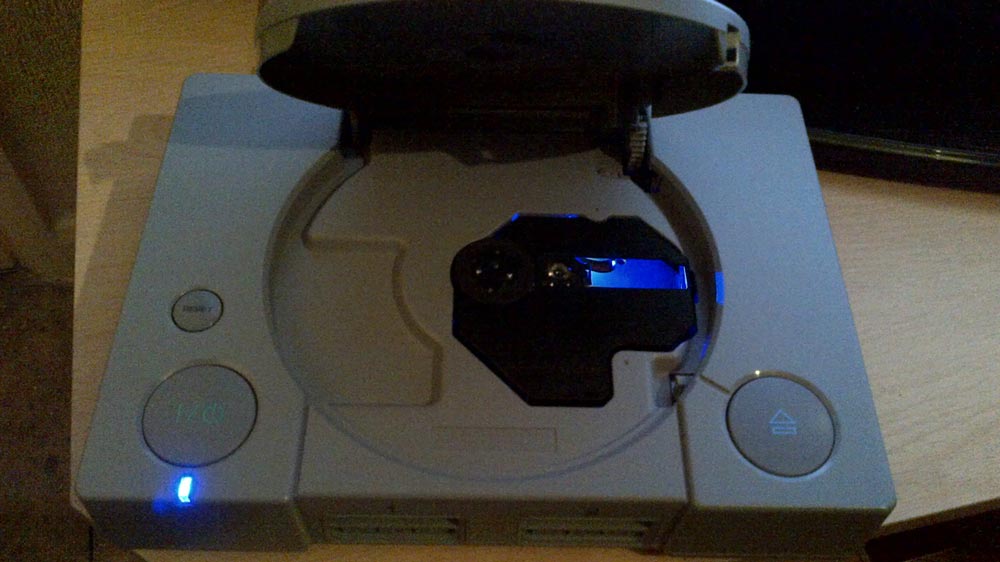

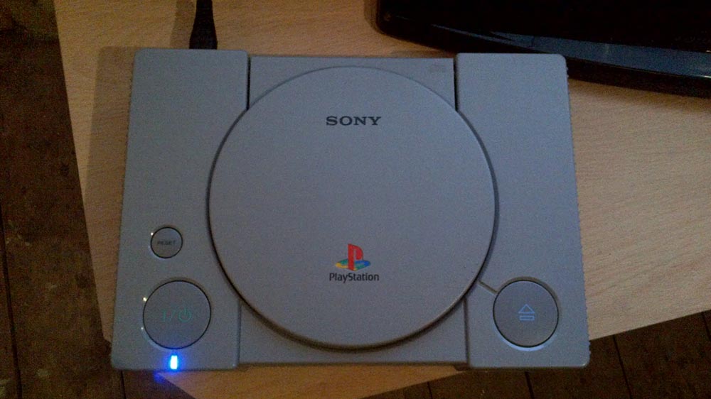

    Just finished cleaning up my SCPH-5552 console I got from ebay a while back.
    Was pretty dirty and had a strong piss like smell :/
    I ended up going super turbo with the cleaning. Every single part of the machine got a full service.
    Looks and smells really nice now.
    Also;
    - Replaced the whole laser/drive assembly with a brand new one.
    - Fitted an MM3 Stealth Modchip.
    - Through in two blue LED's purely out of boredom. Power button, and under the drive.
    I'm happy with the result. Looks really nice now.
    Pictures aren't exactly great though.
