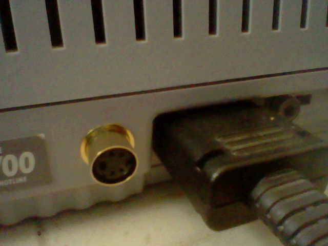

    After adding a S-Video port to my SNES, I found that it wouldn't turn on anymore. After a while, I realized that the grounds were poorly wired, so I soldered a bit of wired to the lugnut. Now it works fine and colors are more vibrant.

  11. ApolloBoy
    ApolloBoy Gutsy Member
    Sep 22, 2011
    425
    Why is it mounted sideways?
  12. dc16
    dc16 Dauntless Member
    Jan 20, 2013
    751
    I had to attach the ground to the nut, and I was not about to take it apart. It was a minor annoyance to fit the wires so it didn't bother the shielding.
