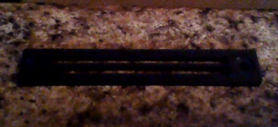

    I resoldered the power cord socket thing on my Model-2 Genesis which fixed it's power issue :) I accidentaly left this part out though, what does it do?

    just a support for the cart slot pics a bit fuzzy but think thats what it is, goes between the motherboard and the bottome part of the case. you should probably open it up and put it back in :D
  8. Shinigami
    Shinigami Rapidly Rising Member
    Dec 30, 2012
    80
    ok thanks for the info, i planned on putting it back in but just hadn't gotten to it because of the large amount of screws lol
