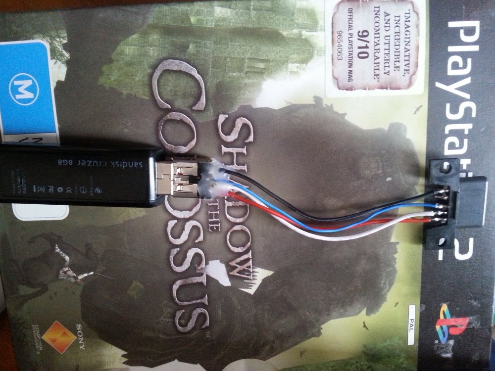

    Thanks Guys
    I borrowed Cruzer Flash drive off a friend, and I formatted it to FATX.
    I can see partition zero, but when I try to drag and drop the two folders in it, nothing happens...
    Every step of this mod is going to be a challenge it seems.
    Any ideas why I cant inject the two folders to partition zero?
    I am using windows 7.
    Thanks

    I have managed now to inject the two folders as per your tutorial...
    However, the xbox still displays the memory as damaged when flash stick is inserted into the controller.
    Thanks

    292
    Format the usb in the xbox then start again in windows
    in fatx tool does it say your MC is supported? I couldn't get my 8gb usb to work I ended up usin a old 2 gb cruiser

    Thanks!
    I have managed to copy the game save file onto the console, using some old photo camera memory card!
    I have managed to complete the mod.
