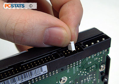

    Setting the HDD status is done mechanically with a small plastic jumper block that bridges 2 of 10 pins on the end of the drive, it will look something like this:
    There will be a diagram on the drive label telling you where to place the jumper to set the drive to Master.
    If the PC bios doesn't "see" the HDD (unlikely in my experience" you can try hot-plugging the ide cable into the powered drive when you have the XBHDM menu displayed,
