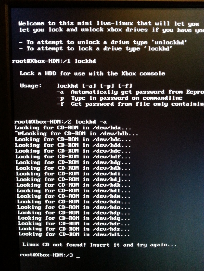

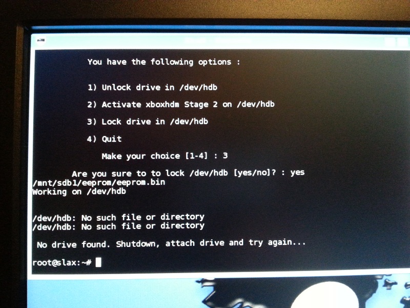

    I have just tried what you suggested above, and still no luck. The drive is definitely "unlocked", because that is how it got screwed up in the first place.
    As soon as the main menu of xbhdm comes up, I power up the xbox, wait for a few secs, then disconnect the IDE cable from hdd, and connect IDE from PCI IDE Card to xbox hdd, this is all done before xbhdm boots into option 1 (VGA console, or something like that) by default, and then I press 3, to boot into "lock/unlock" drive options.
    Howerver, when using xbhdm 1.9, I am greeted with this message
    When using xbhdm 2.2 (USB version), this message comes up.

    XBHDM should actually bypass the BIOS...
    Try hot swapping but whilst in the bios ie:
    Power PC (enter bios)
    Power Xbox
    Disconnect Xbox hdd from console (ide only) and plug into PC IDE
    Exit Bios (Not saving settings, if you hit the reset button it will cut power from IDE and may make HDD lock up)
    Load XBHDM (either USB or via cd, if via cd have CD drive set too SLAVE)
    The Via chipset (your PCI card) might not be supported by the USB version of xbox HDM (no drivers).

    the VIA ide chipsets are supported in DOS but might no be supported under linux, thats why the usb version isnt working for you..
    There should be jumpers on the pci ide card, what are they set too

  20. gandalfnz
    gandalfnz Spirited Member
    Jul 30, 2014
    113
    Hi Guys
    I am still having issues with this unfortunately. I got an AMD machine, with two IDE slots and IDE DVD RW drive. Now DVD Drive gets detected fine in xboxhdm.
    I have managed to rebuild the drive completely, however I cannot seem to be able to lock the hdd now.
    When I try to lock it, I get the following message.
    Thank you!
