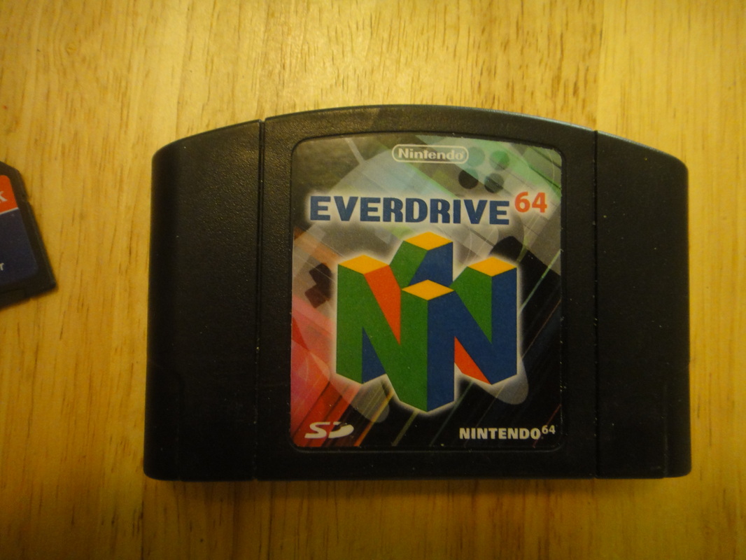

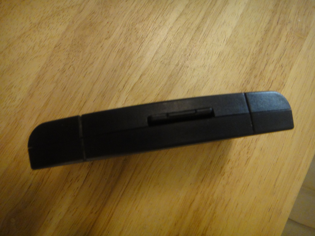

    hey everyone i got my everdrive and made a nice casing for it with a label image i found here
    hope everyone likes it

  15. NDS-Maister
    NDS-Maister Newly Registered
    Jul 5, 2011
    Wow, this is the label that I made.
    I love it. :love2::love2:
