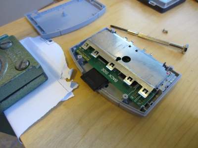

    Changing the SD card did the trick! Now all the aforementioned games boots just fine :)
    The SD card was actually just about the only thing I ruled out as a problem source, as the games seemed to load as they should. Tried to swap AV cables, resolder the CIC chip, putting washers between the PCB and the plastic shell, compensating for the removed RF shield, to get the positioning of the PCB right, and so on. Should have tried another SD card first. Ah well, it's easy to be wise afterwards I guess.

    guys, do not remove metal shields. better to modify shields and leave them in shell. it is pretty easy

    Ah, that was easy enough. Silly of me to not think of that possibility before :)
    A little advice though; when straightening out the shields, try to avoid getting a protrusion where the fold was, it will make it hard to put the casing together.
    It's still too early here to go about flattening the bump out with a hammer, so I just bent the sheet metal back a bit, which lessened the bump to a degree where it was possible to close the casing without any mechanical strain.

    If you have tin snips, I found it much easier to just cut them off.

    Could probably do it with a pair of regular scissors too, that tin isn't all that thick. Got a nibbler at work too, if that doesn't work :)
