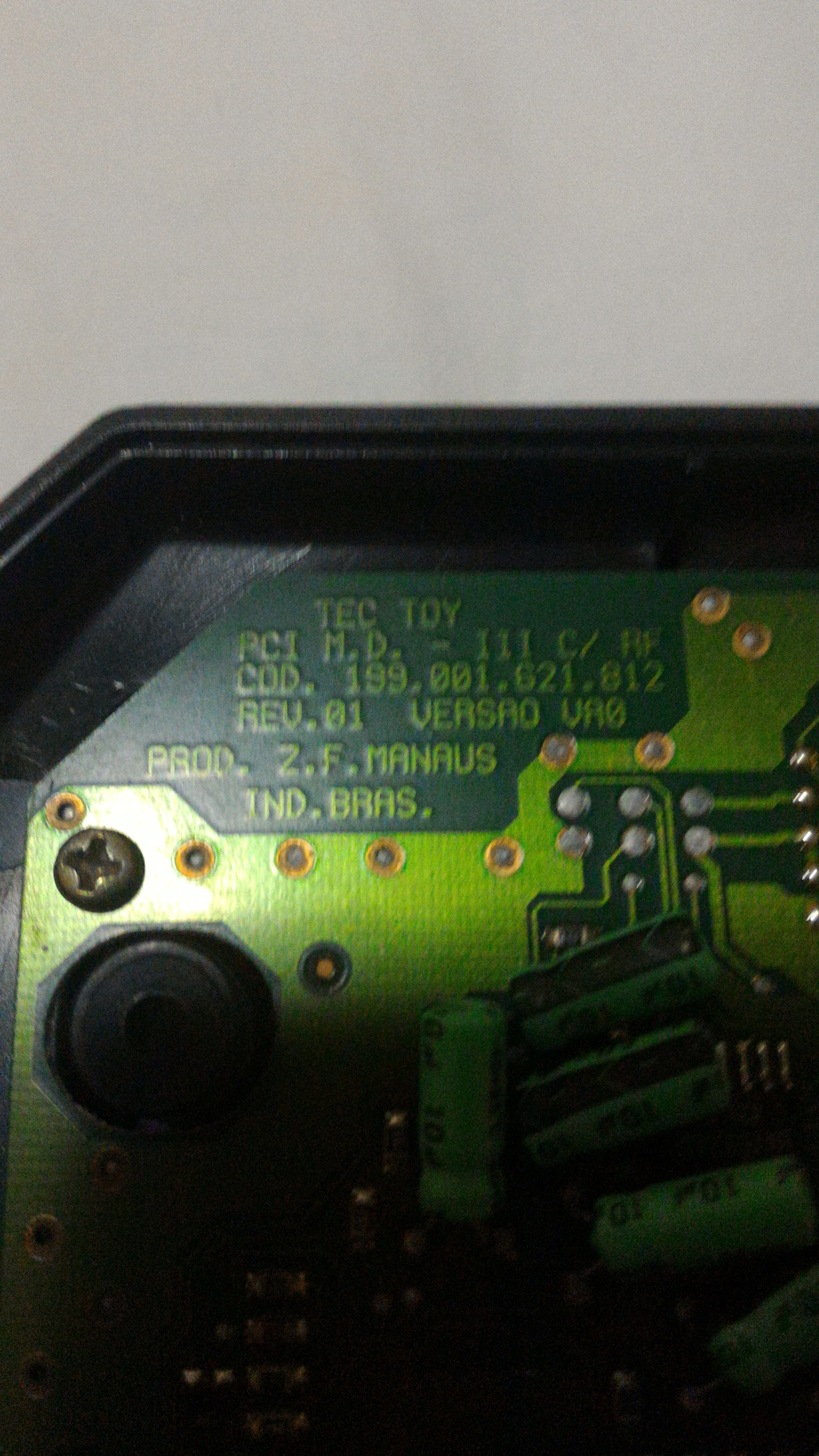

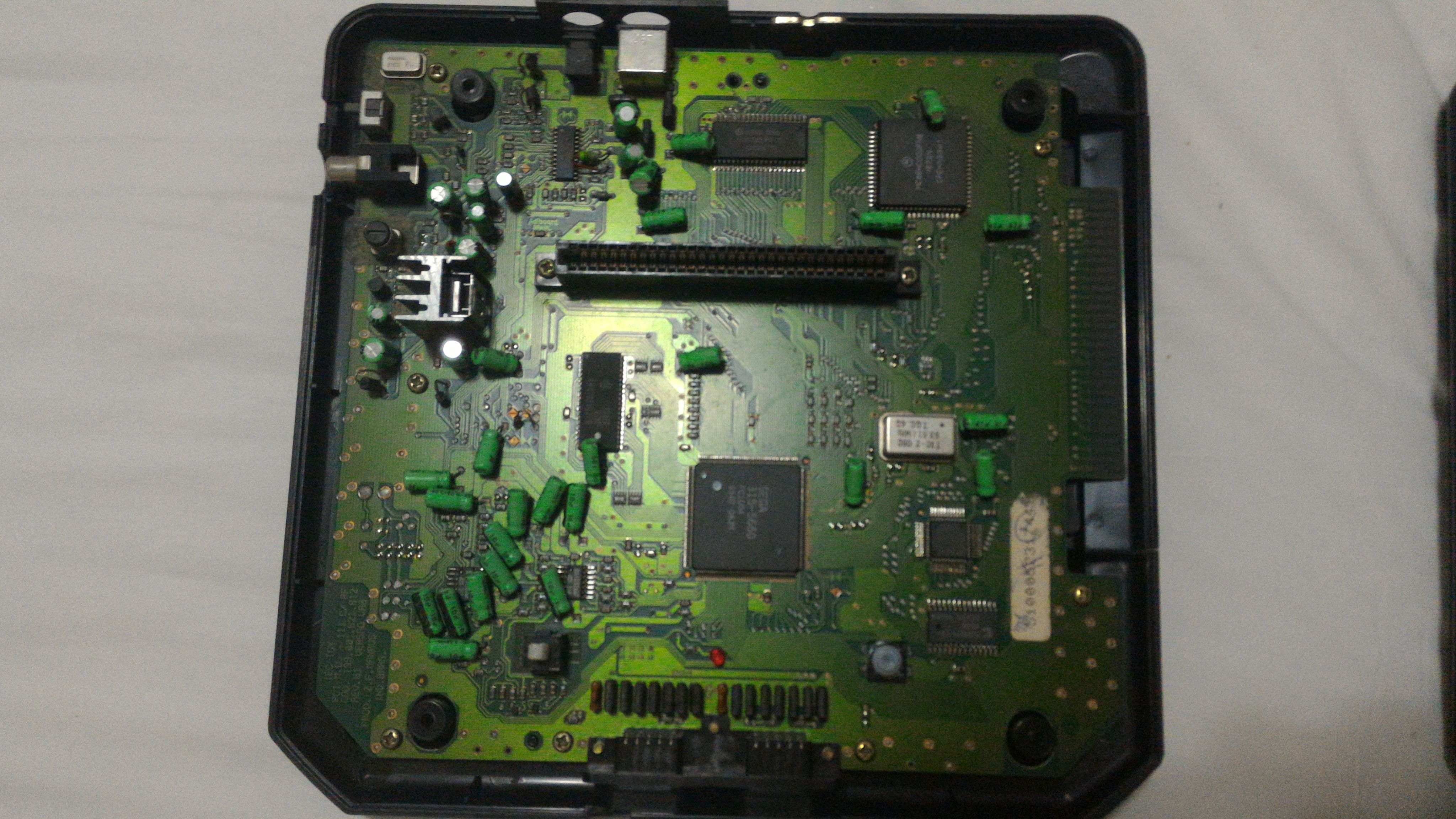

  19. Herberth Denny
    Herberth Denny Newly Registered
    Dec 28, 2016
    Hello Helder. Nice work. I've seen the samples from a lot of users and i'd like to acquire 1 Mega Amp for a Genesis model 2 VA0 (if i'm not mistaken - see the photos added). I live in Brazil and need instructions to pay you. Thank you, and Happy Holidays. IMG-20161220-WA0028.jpg IMG-20161220-WA0035.jpg
