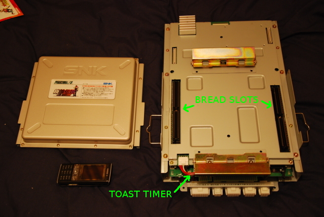

    Out of interest.
    What are the white socket/plugs we can see in the picture here?
  11. Borman
    Version 1 boards needed an extra harness for power and sound, or something like that :p

    so does that mean this thing won't work with a regular jamma supergun? I've never looked into the ng64 hardware before because...well....I'm not a fan of the games on it
  13. retro
    I think this should answer your question:
    Yes, of course. All arcade boards require a PSU and a display. Most boards won't have a "domestic" connector on them (e.g. VGA) and so need a harness of some kind... i.e. a "supergun".
  14. Jamtex
    Feb 21, 2007
    5,472
    Surely it's a flat grill as you can see the little catches on the left and right to hold it down. :D
  15. Parris
    Aug 18, 2006
    6,248
    I think you put the toast down flat, hook the ends of the bread in he metal arms (thus pinning them down securely), then you place that neat metal lid on it and voila, a toasty maker that also imprints the letters S.N.K. onto your bread! Standard kit when I was in the Army :nod:
    Couple it with an early Xbox 360 and you've got yourself a pretty good breakfast making kit, toasted bread and cooked egg sarnies!
