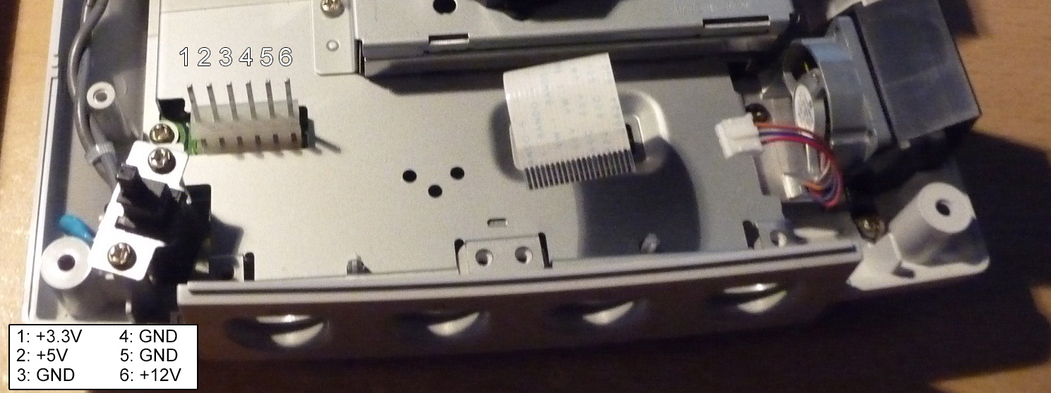

    Anyway - main reason for my post lol - is I want to use a remote switch for the gdemu. I was talking to the guy who makes these: http://rfpcremote.com and he was saying that his switch did not need to be on a 5VSB line - and would work fine on a +5V line when the unit was powered up. I like the idea of a remote switch as I could then use the audio menu as a selection menu - and even if in the future new firmware is included with a menu - this would still reset the console remotely so not a waste.
    So my question for far more technically minded people is: If I soldered this to the +5V and GND on the power pins - would I be taking power away from a necessary part of the system?
