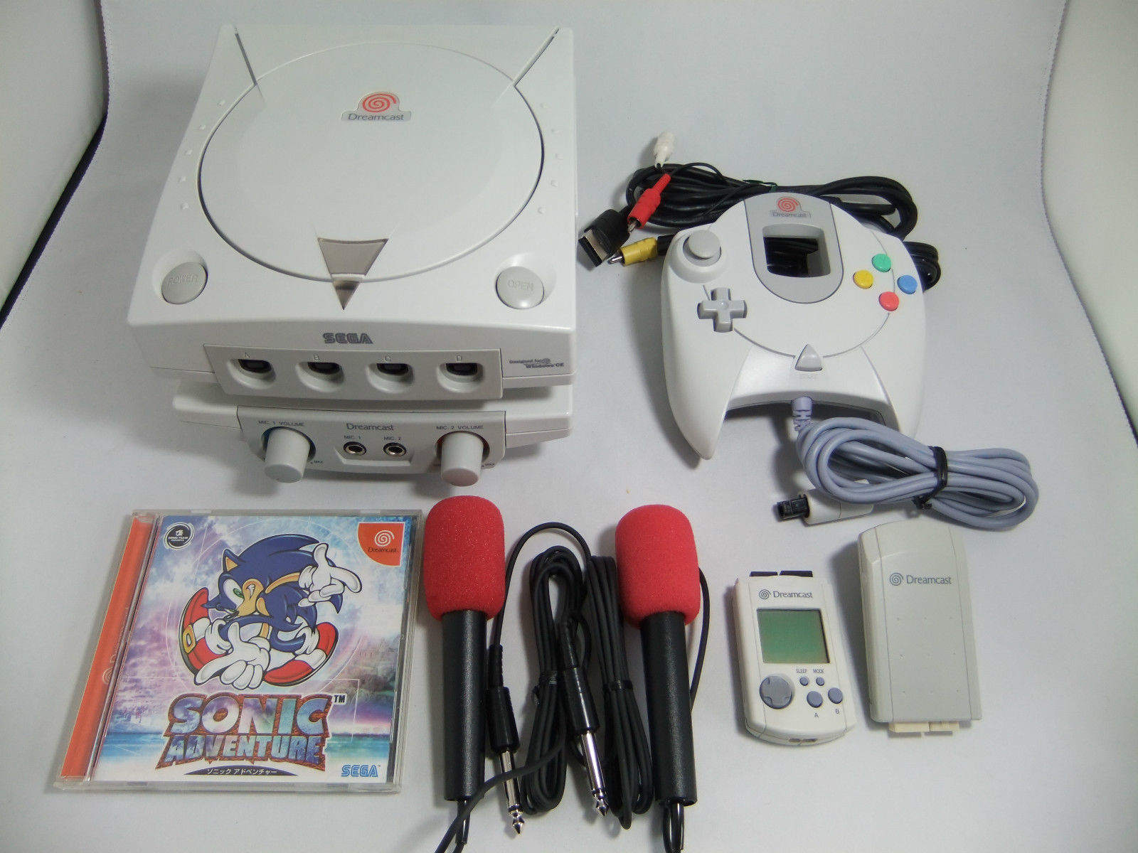

    This might be a stupid question but has anyone thought of a convenient or streamlined way to connect the HDD to the dreamcast? Say maybe with a case similar to the old zip drive or Segakara? Does the G1 connect throught the expansion port? If so that would be a great way to enclose the HDD since the Segakara is not functional anyway.

    I don't know what a segakara is, but G1-IDE-ADV could work without the gd-rom drive so you can simply put it once in the DC along with a hdd and forget about it. I guess there could be a way to hook up the HDD via the opened lid for convenience. The G1 bus is only accessible via the gd-rom port on the motherboard, not from any external connector.
    this is the segakara attached to the bottom of the dreamcast. it uses the expansion port that the BBA or modem uses.
  15. Helder
    Apr 6, 2013
    981
    54
    Here is another stupid question, how can anyone find those readily available today? Seems unlikely to get them cheap and they aren't on the same bus as the GD1.
