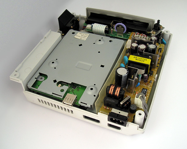

    Looks nice. Just wondering, do any of the screw holes line up so it can be secured? or is just the gdrom and usb connectors holding it in place?
  2. citrus3000psi
    Nov 8, 2013
    1,051
    418
    Its the latter. No screws line up.

    That's a shame - I took apart an old GD-ROM assembly and pulled out the main board - and it looked to have all 4 mounting holes in the exact same locations as this new USB device, so was hoping it could be securely mounted inside the assembly and then mount the assembly as normal and secure it to the dreamcast.
  4. citrus3000psi
    Nov 8, 2013
    1,051
    418
    It would be simple to make a bracket to secure the unit tighter. But if you cut the hole in the back properly its not going anywhere.
    I also talked to mnamo today and he is working on disc swap support. Hopefully its a firmware update and not a different piece of hardware. Granted I'd sure i'd have to wire in a door switch with the current piece. The device has no idea if the lid is open at all.

    Oh, Mnemo gives you a guide for filing down the USB hole. Cool. Thanks for the pictures, Citrus.

    The screw holes are for this, I assume so air flow kind a flows like it would with the GDRom drive attached.
    & damn looking at it in those pics, makes me want mine more lol I'm so impatient.

    Something I wanted to post yesterday but forgot - What's it like for heat in there? I remember users commenting that Denuan's board made the DC get very hot - although I'm not sure how this was followed up? Was it okay in the end?
    Also, as tempted as I was with these - I still think it's best to wait on Cybdyn's board - that sounds like it's going to get the most support (decent menus for a start!) and none of this push a button on the board to play next game. I can easily see that button breaking very soon with heavy use.
    I say hold out - there are two on the market (kind of) so it's been done - now we just wait for the best supported version to get released, decent menus, better options to change games directly from the pad, etc.
  18. NightbreedUK
    NightbreedUK Rising Member
    Jun 6, 2014
    65
    Can't speak for others experiences - but with the GDEMU the PSU does get hotter (Some of it down to airflow - and some of it probably down to the PSU being less energy efficient) However even though it gets hotter it's not too hot to cause a problem, in fact my unmodified Saturn PSU gets hotter lol. Anyway even after playing for hours there have been no issues :)
    As far as the select button goes - I just wired up a RF remote switch with 2 buttons (previous image / next image) so have no worries about the button on the GDEMU wearing out.
    Having said that - this USB device looks awesome - and because you can use your GDROM casing the airflow (apart from no spinning disk) should be pretty much unaffected and I would guess the PSU would not be as hot as with the GDEMU - but only time will tell.
