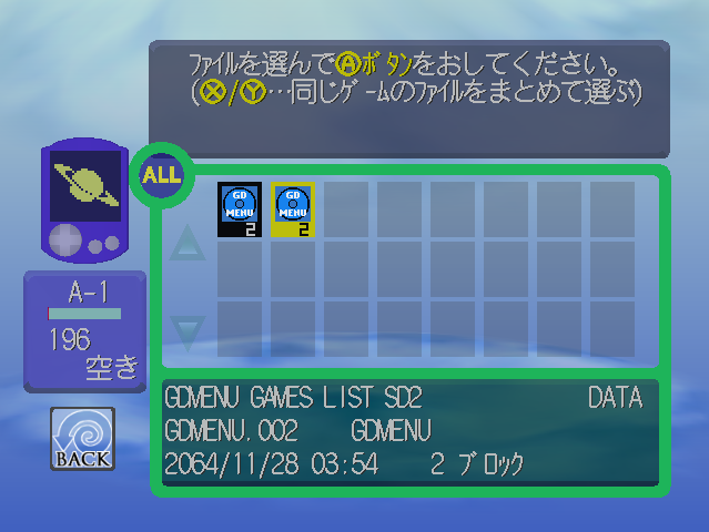

    GDmenu v0.01 for GDEMU
    Hey guys, I was bored and decided to develop a very basic menu to use with the GDEMU.
    If like me you have your dreamcast collection spread across a few 32GB SDHC cards, you know how much of a pain it is to navigate through them and select the game you want to play.
    Hopefully this application will make that process less painful.
    I decided to call it "GDmenu" and it is just a temporary solution while we wait for Deunan to release his menu.
    I wanted to make it simple and as easy to use as possible.
    It was made in a couple weekends of work and with no previous experience in dreamcast dev/KOS.
    Some bugs are to be expected since it went through very little testing, although I haven't had any problems so far and KOS is very stable.
    It displays the currently selected game name and the disc number in case its a multi-disc game, based on the info contained on the ip.bin.
    After selecting the game you can just hit the (A) button to start it.
    You can also build a list of the games present on your SD card while cycling through them and hitting (X) to save it to the VMU after that.
    Next time you start the menu the list will be loaded automatically.
    There is also the possibility of saving multiple lists and cycle between them with (RT) and (LT).
    Each saved list contains in its description the number of the SD card that it belongs to.
    Pressing the (Y) button allows you to go back to the BIOS menu.
    In case you want to get rid of a list simply delete the corresponding save file from the VMU.
    The lists are saved and loaded from the VMU on A1 port and each one occupies 2 blocks.
    Unfortunately you still need to use the tactile switch on GDEMU to cycle through the games (a remote pcb with two switches helps a lot).
    But anyway I find it a much better solution than using the built-in music player, because a lot of games don't have the 0GDTEX.PVR file.
    Hope this is useful for the people out there with a GDEMU.
    Download
    gdmenu(23-8-2014).zip
    All you need to do is extract the gdmenu.cdi and copy it to the folder 01 of your SD card and rename it to disc.cdi.
    If that folder is already occupied you can always use the "GDEMU SD Card Maker" tool by madsheep to rearrange your folders.
    Also to make the menu more responsive it is recommend to add a file name GDEMU.ini to the root of your SD card with the two following lines inside:
    open_time = 150
    detect_time = 150
    More info on that inside the accompanying readme.txt
    Feel free to report any bugs or make suggestions...
