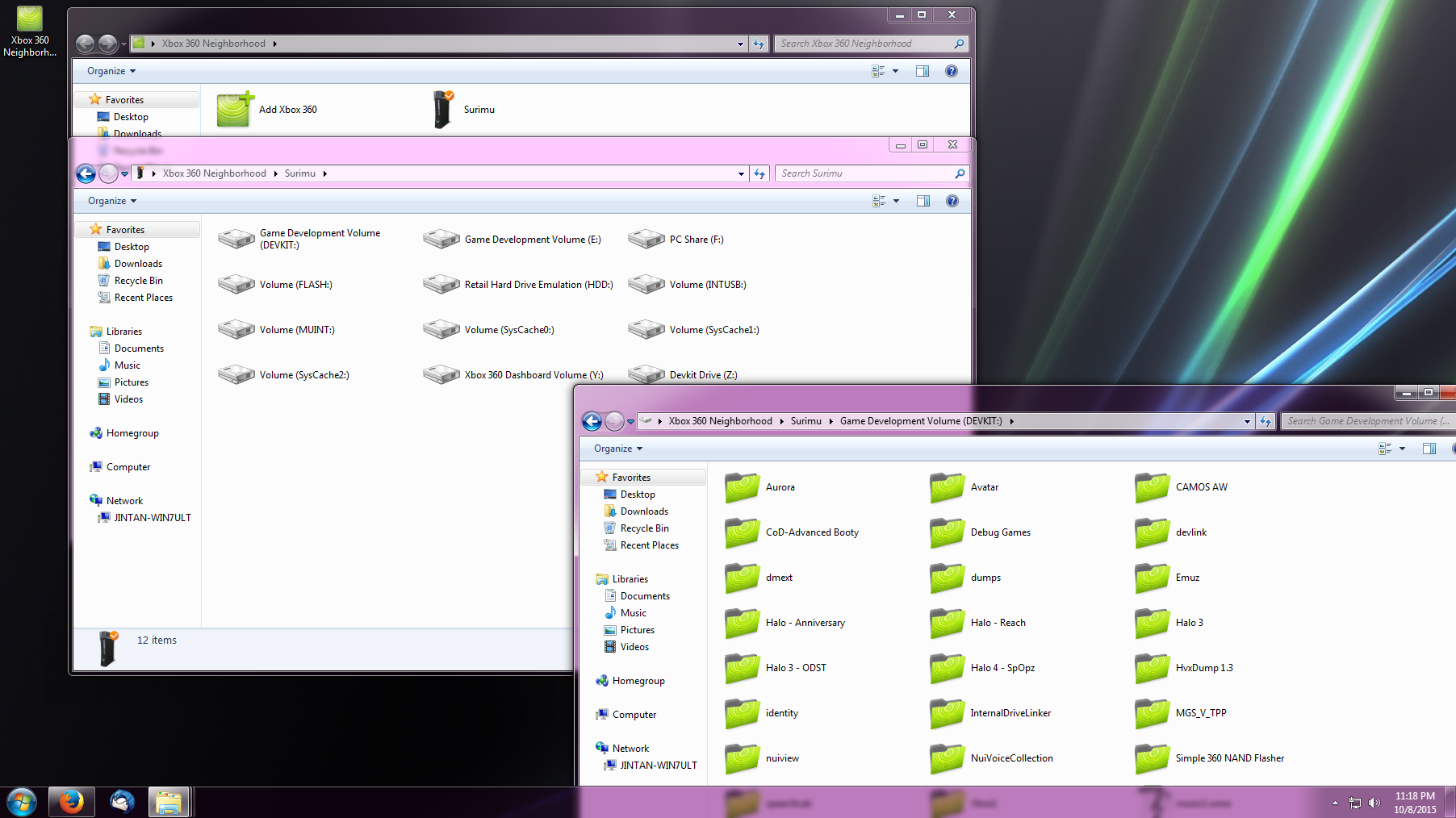

    You can FTP to it or even setup the SDK neighborhood to have the hdd show up like any other folder.

    Anywhoo I recommend setting up Xbox 360 neighborhood but I don't know how you would do that on a retail system, I just know it's possible.
    Your Xbox will show different drives since yours is a retail system while mine is a DevKit but the usage is the same.
