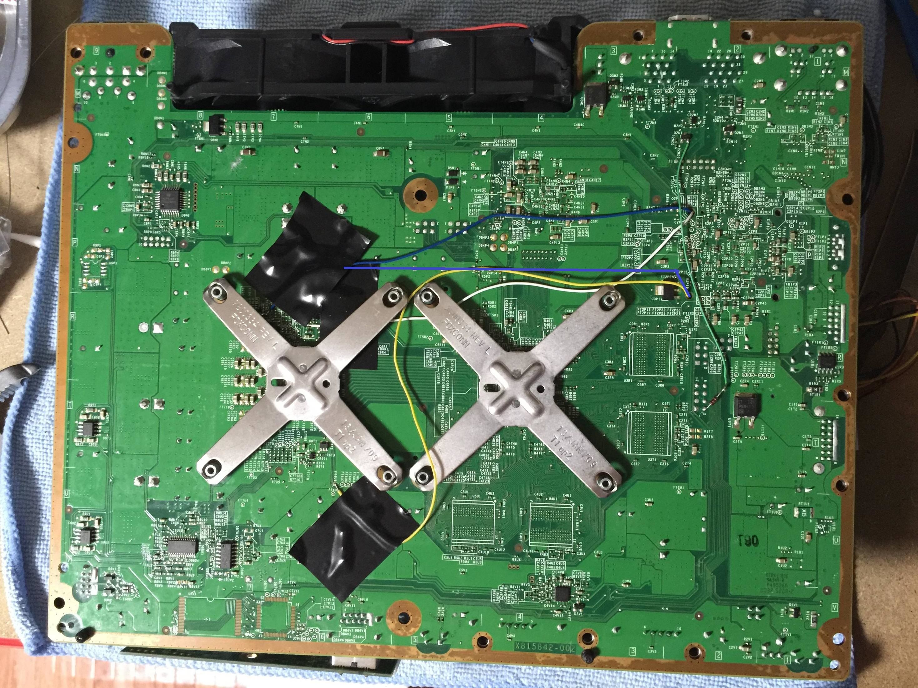

    Okay, I've taken another crack at this by doing away with the QSBs and moving the blue wire as suggested. Still can't get XELL to boot! Getting about ready to boot this thing off a cliff. I very briefly got it to go somewhere though:
    CR4 Selected
    Version: 10
    Power Up
    Waiting for POST to change
    Post 04 - BOOT SEQUENCE STARTING
    Post 06 - ....
    Post 2E - LOAD XAM
    Post 7E
    Post 7F
    Post 7F
    Post 3F
    Post 3B
    Post 33
    Post 03 - ...
    Post 01 - .
    Shutdown
    CR4 Selected
    Version: 10
    Power Up
    Post 20 - ...
    Shutdown
    For some reason, it now only gets to post 20. It still doesn't automatically turn on when I start a rater test, I need to manually turn it on. It does automatically switch off when I stop the test.
    Here's the install:

  4. gladiator5
    gladiator5 Robust Member
    Jun 25, 2012
    284
    I am totally not a pro in rgh modding.
    But There is a good chance its the route of the wires.
    Can you make one picture over viewing the back part of the motherboard? So that its visible how all the wires are going :)
  5. FireAza
    FireAza Shake! Shake!
    May 31, 2012
    2,003
    25
    Okay, here's a whole photo:
  6. Madsmaten
    Madsmaten Gutsy Member
    Sep 6, 2012
    497
    149
    Is the diode grounding with the metal casing, when put together?
  7. FireAza
    May 31, 2012
    2,003
    25
    I haven't put it back in it's shell yet, still trying to get it to work first.

  11. FireAza
    May 31, 2012
    2,003
    25
    Okay, I've tried moving the blue wire to where you marked, but it still not only won't boot XELL, but it still won't post at all in rater. It'll be just my luck that I've got a dud CR4 that was never going to work anyway and has killed two systems. At this point, I'm about ready to just ask someone to send me a pre-modded system.
    *EDIT* I'd been advised to flash the stock NAND image back and remove the CR4 from the console to see if it will even boot the original dash. And it does! Simply flashing back the stock NAND didn't get it to boot, but removing the CR4 did.
