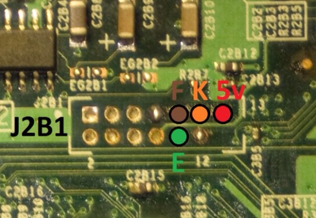

    Orange cable? The one on the wire-free install guide that's connected to DB1F1? Wire that to the kiosk point on the CR4XL then connect it to the JRP?

    Have u got the post bit jumpers set?
    Make sure u have one of them set. Have u been following official team xecuter guide I linked earlier in this thread?
    The orange wire u are looking at must be from cool shrimps guide. That is just jtag wiring, not sure why he used orange?
    This is kiosk point.

    I've left the post bit jumpers at default, apparently moving them is more of a fine-tuning thing? Yeah, I've followed that guide down to the end.
    I don't currently have anything wired to K, I'll add that wire and see how it goes!

    Okay, I made a discovery: Some dingus at the factory had installed the post bit jumper around the wrong way! It was bridging ACROSS the pins rather than joining two pairs. Correcting this gives me the behavior you mentioned above (green light blinks every few seconds accompanied by the fans spinning down). Still nothing on screen though.
    I've run Rater, which ended up involving further soldering since I'd cut the wrong cable when I was removing the plug for the NAND soldering. Anyway, here's what it had to say:

    Also, after I'd left Rater running, the console shut down and gave me three blinking red lights. Uh, is that normal?
    Oh, I also decided to move to the grey wire back to it's normal solder point. Not sure I trusted that alternate point from that YouTube video. Here's what it looks like now:

    Always good to check your setup, don't rely on the factory guys. Looks like u are back on track. That post out looks like u are passing the glitch but failing at the jtag part. Double check your jtag qsb soldering and post a picture of jtag with Q2N1. When u got 3 red lights, what was the secondary error code? Always check this when u get red lights whilst glitch modding.

    Okay, I've re-flowed the solder on the JTAG QSB. I thought it looked fine, but eh, why not? Also re-flowed the join at Q2N1, it didn't look quite right. Here's what it's looking like:
    Still getting a black screen though.
    How do I know what the secondary error code would be? All I saw was the three red lights, do they blink in a pattern?

    U won't get xell to show on screen until it successfully boots. Watch your rater log to give u clues. It should post all the way to post79 when successful, at the moment u are failing at post25. Jtag looks good. Try all rjtag dip combos with post bit jumper on 0, then all combos on next post bit etc. have u got 7,8 off for jasper?

    The jumper on the JTAG QSB is set correctly isn't it?
    Which is left and which is right on the postbit jumpers? I've either got mine set to 0 or 10, I can't tell! Nah, I've left the dip switches all at 0 since this is suppose to be the correct setting for a Jasper.
    Should I be fiddling with it a bit?

    What happened to your post cable?? :p
    Looks good. Now try dips 1-6 one at a time for each post bit jumper until u get a boot. Good luck.

    Like I said before, I mistook it for the NAND cable since has the same number of wires and colors :p
    Do I flick the switches while the console is trying to boot or am I suppose to power off each time?

    Do it all from rater at this point, so stop the Rater, change setting, start rater. I would let it cycle 10 times for each setting. It's a good thing u bought the Jrp, it's very hard to troubleshoot without access to the post log.

    When you say "one at a time" do you mean say, flick 1 to on, if no improvement, flick 1 back to off then flick 2 to on? Or should 1 be left at on?

    Yes, try each dip one at a time. Should be 18 combinations. 6 dips x 3 post bit jumpers.
