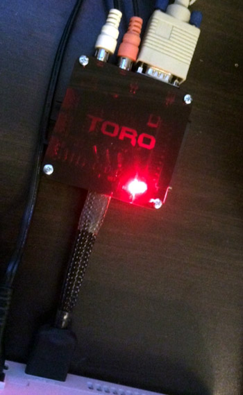

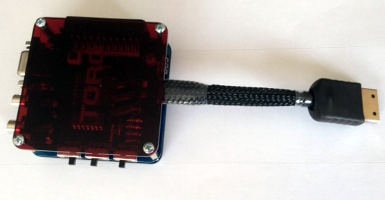

    Is it cool? Comes in cherry flavor also...

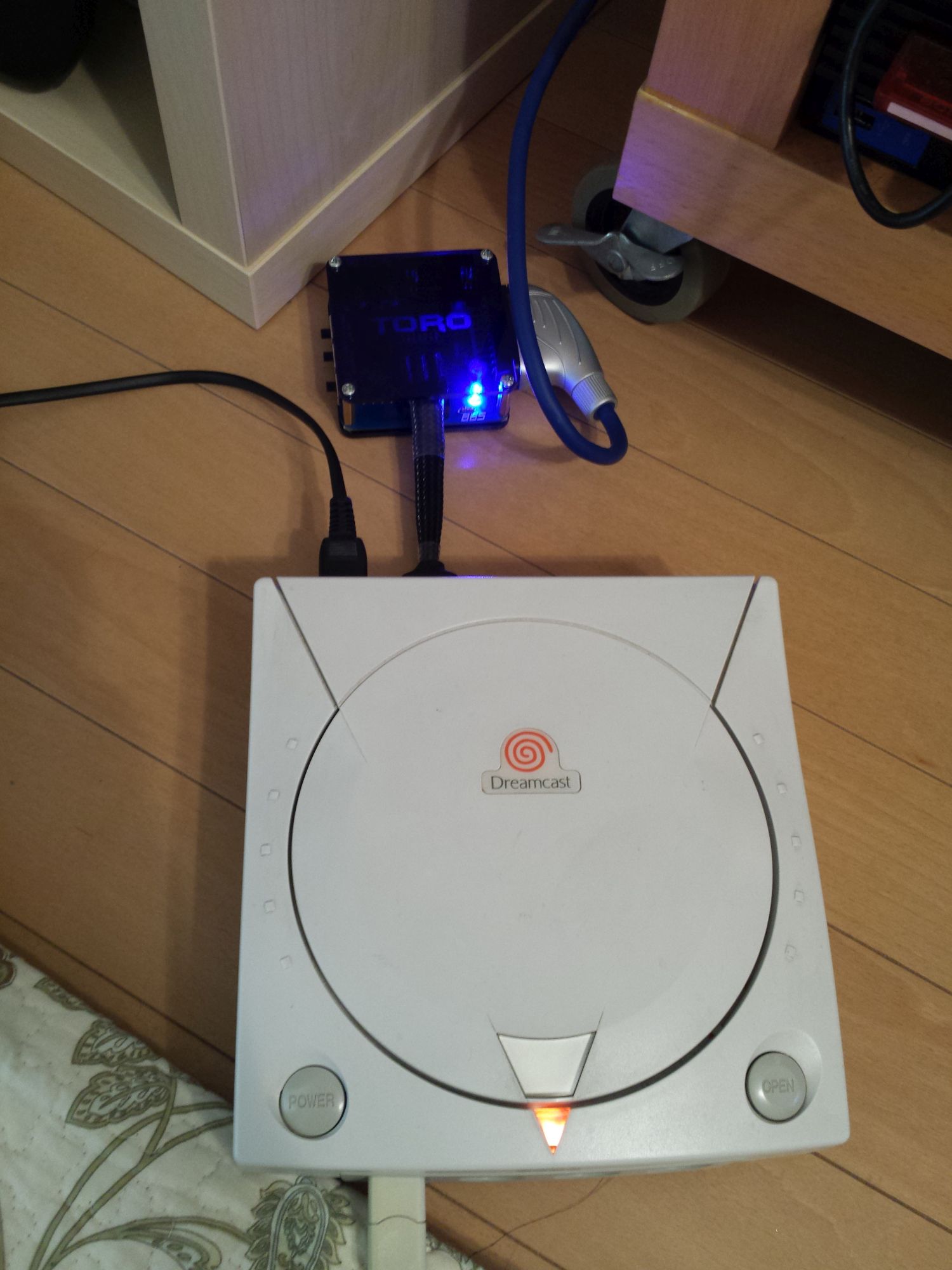

    It is a bit of a shame about the SCART socket. All right-angled SCART sockets were that way round - you really needed to either design it with the connector on the other side, or use a chassis mounting socket. It will be a deal breaker to some - cable management is considered quite important nowadays and I know I'd be irked with them sticking out all over the place like that. Perhaps it's something to consider for a future revision.
    By the way, those flat SCART cables suck ;)

    Thanks for your comments. I think using a scart connector with the opposite angle can force the console too much and pull the cord from its plug which causes improper or no operation of the cable. I tested standard simpler black cables too, works better, more flexible than the thick one in the photo. Also it's really difficult for me to find these connectors. You can also use the VGA connector (for the RGBS Csync output) with the XRGB, though you need a custom cable for that.
