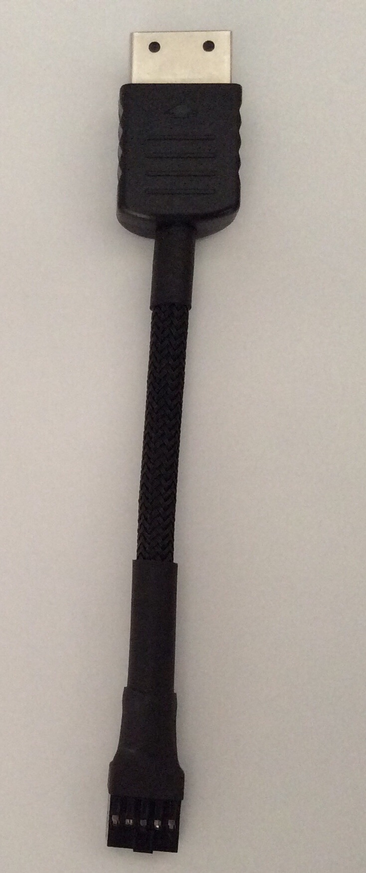

    I bought a Toro earlier this year and everything was brilliant until today. Now I only get left channel audio from the Toro. If I press down on the Toro connector at the back of the Dreamcast, I get stereo but if I let go it's back to left channel only.

    312
    The AV Port might be dirty. Clean the contacts on the AV port with a q-tip and the highest % rubbing alcohol you have.

    15
    I did, the Toro is doing the same thing on 3 different consoles. I think there's some broken wires or something in the braided part of the cable - now it won't even give me stereo when I press down on the plug.

    312
    Ah ok. The right audio pin on the plug might be bent out of place somehow. Does the plug look odd, like a pin that's lower or higher than normal? If so, try moving that pin up or down.
    A broken wire would mean right audio wouldn't work at all.

    312
    Everything looks fine. I'm not sure what's wrong then. It might be a loose wire in the plug.

    101
    I can send you a replacement cable, if aligning the second pin (R audio) doesn't work for you.
